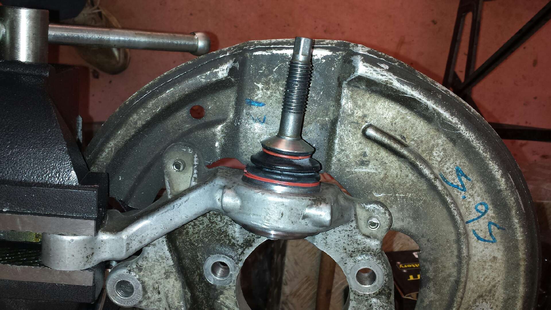

My RHS lower ball joint came loose last week and the shop tightened it yesterday. They were new in March 13. The steering felt very wrong. Today the nut came loose again after 50 ks: about 4 turns. I rang the shop and they said they loctited it and used a metre bar.
I just put it back in with loctite and rattle gun. No taper on the shaft just a straight bolt like the pics on Ebay. Can peoples confirm that is right ball joint... Paul

That's the part we are all mauling over - it's the taper below the threaded part that's different between pre-2004 and newer design.
You can see in the eBay link that sjgh linked above(no offense sjgh) that it's straight. It's not the right part for our post 2003 S Types. The newer suspension design uses tapered design like the one I linked above for XJ8.

My ball joint finally seized today and the nut undid itself. I pulled it out using the rattle gun from Milwaukee in about 20m. It was new in Mar 13 but judging by the hammer blows was put in wrongly. The two mechanics told me they fixed it by tightening it and when I asked why was it loose they said " Dont over think it" Der... I also saw the boot was split so no grease didnt help. I found a new BJ for $50 and it looks perfect for a 2000 14 mm straight bolt system.. like all the ball joints are in this model including the steering tie rod end. The existing one in the pic is about 4mm deeper than the other side but the new one looks perfect , Paul
