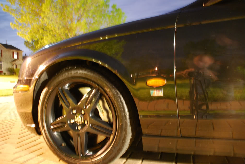

Mine is lowered on H&R Springs....love them! Handles like the car should from the factory, tigher and more sport like.....and the ride comfort really did not suffer at all.....and it just looks badass!

Yes she indeed looks great! Would you happen to know if 20" would rub with those lowering springs? thx

I htink w/ 20" wheels you will be fine and clear if the off set is correct.....there still is a slight gap as you see.....and you will lose tire wall height and the ride will be a lil rougher with less of a sidewall to take the bumps
