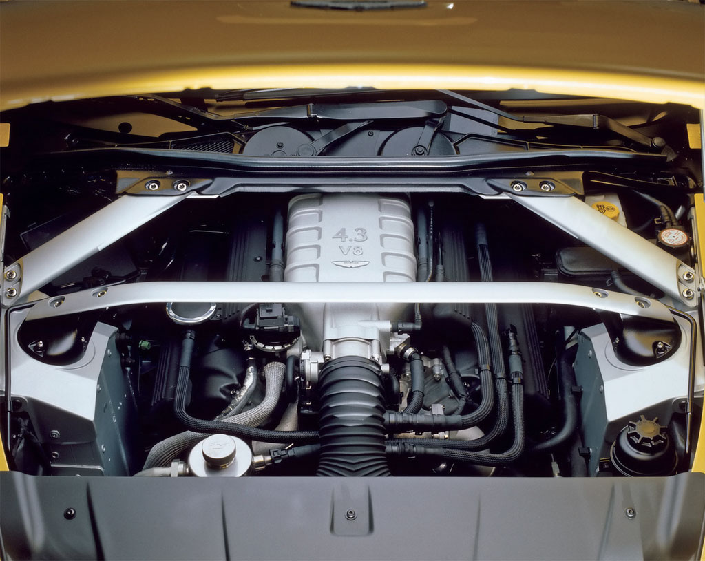

The factory has something very similiar attached to the strut towers and fire wall already?
Here is an Aston Martin version with the Jaguar based 4.3L V-8. Now this is some bling!!
