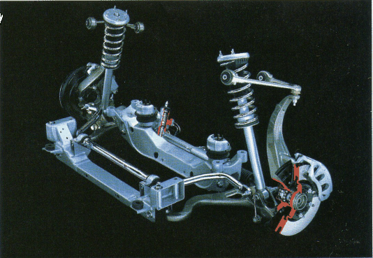

From a historical perspective, Jaguar significantly changed the front sub-frame and suspension during the gen I to gen II face lift. (2003) You can see differences in the attached images. My “online readings” indicate that they made the front end 10% stiffer. I presume part of this was to handle the STR engine, and to correct some sub-frame flex being passed onto the front suspension. If there was an issue with shock tower stiffness, I am sure Jaguar would have introduced a strut tower cross brace. As far as I can tell, the shock tower’s uni-body sheet metal stayed the same during the change.

Yes. They'd had complaints about suspension, handling and tyre wear with the original cars (those pre-2002.5MY aka 2003MY USA). So they redesigned it all.
The STR has various extra bracing / stronger items as well.
