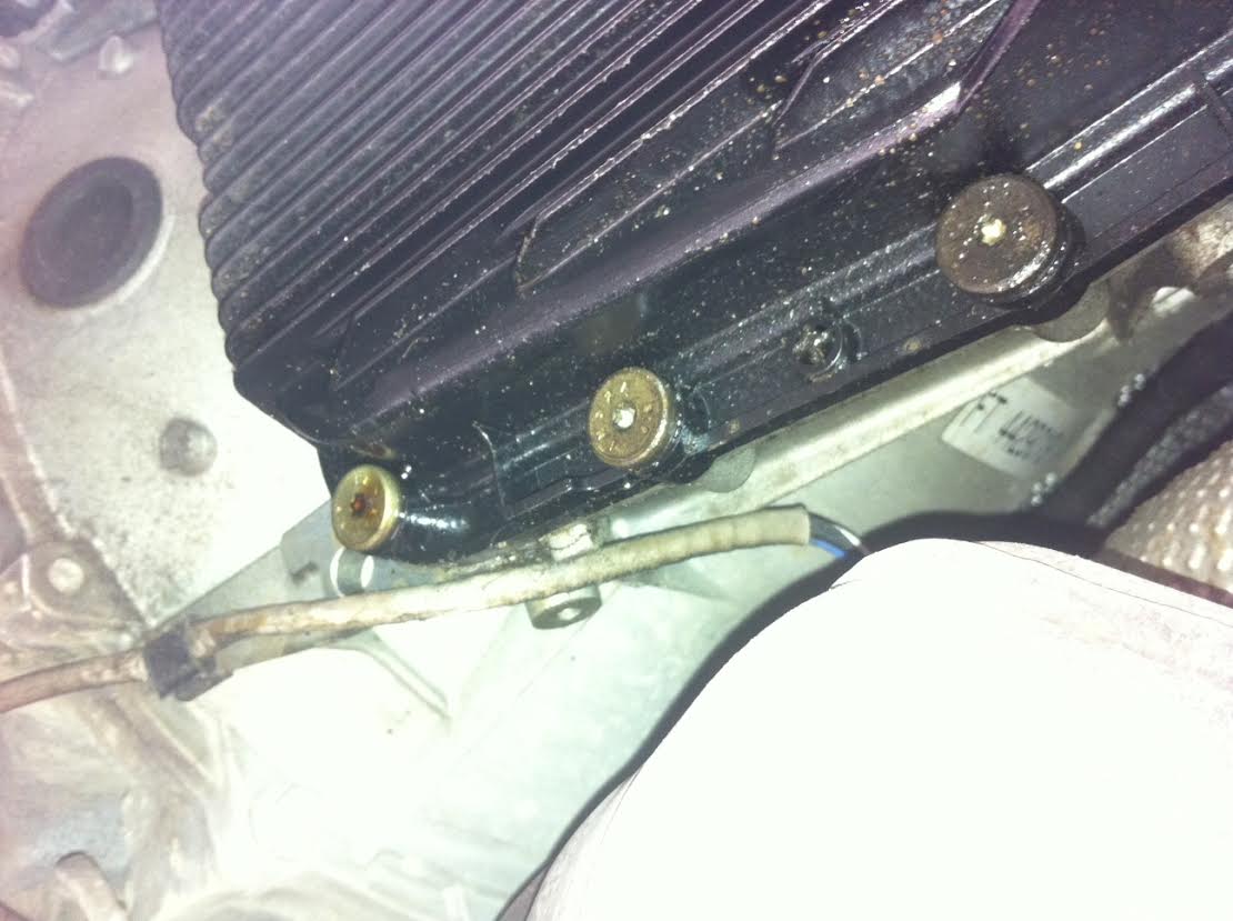

Mission Accomplished fellas finally got to doing a transmission fluid/pan change on my 2005 4.2 V8 S-Type (Non R ). My father came to visit for a week from sunny Southern California and helped out a lot even though he's never done a transmission fluid change on any vehicle nor have I LOL...I put the car up on jack stands, leveled it out and let it sit for a few hours.
The transmission pan had the original T27 screws I could only get 3 loose with a socket wrench...the others just stripped my T27, my father then attacked them with vise grips they loosened up good with them.
We then drained the pan and didn't get much out, 3 quarts maybe...I know where the rest of it was...on the huge oil spot & spots on my driveway.
We then attacked the sealing sleeve ohh man did we go through hell with it...after about an hour we got it LOL.
We then installed the new pan with new T40 screws and filled her up. I used this post by forum member ccc for filling instructions and ended up putting 6 liters of ZF lifeguard 6 in her (https://www.jaguarforums.com/forum/s...ics-faq-30991/) The old fluid came out pretty dark...I inspected the magnets on the old pan and they had no shavings.
Let me tell you after we finished up I took her out for a drive...you could feel that she was happy...she was a little thirsty...and she feels like she just came out the factory !
The random RPM surges I used to have seemed to have stopped...and the hard shifts stopped as well !

Images below are of original pan, fluid and original T27 screws. That's how my pan was.

Wow, that is indeed dark oil! I hope you got to it in time.
Did you change the electrical sleeve?

Good job by you and your dad. That is indeed very dark ATF. When these ZF units get below 8 litres of fluid, the remaining fluid cooks up, gets darker, and begins to disintegrate rather rapidly. I hope you refreshed yours in time. Keep us posted on your ZF's performance during the months ahead....

Yes we changed it.

Nice job and I hate to say it BUT if it was my car I would be setting up for another oil change.
Your fluid looks very black and I am sure another swap would clean it up much better.

+1 ..I Drained Mine Again The Next Day And It Was Slightly Dirty From The Old Fluid That Was Left Over From The Initial Drain And Fill.

Agreed, I don't think its ever been changed in its 89K mile lifetime. I might purchase some more lifeguard 6 this week and swap it.
But let me tell ya she runs x3 times better than before the change
