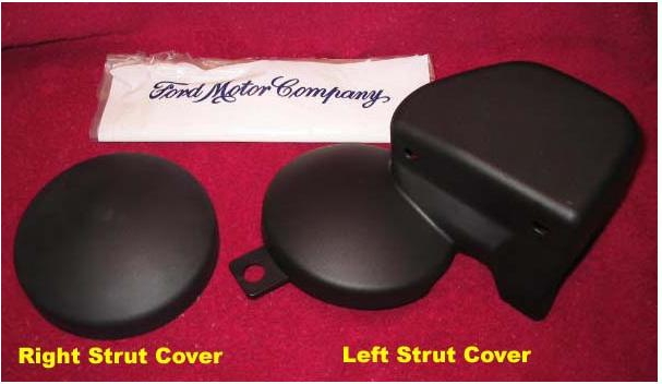

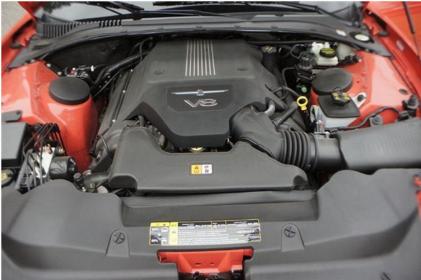

Wrong again. Please read what I wrote. The STR only got strut covers in 2003.
The regular S type and the Lincoln LS, Ford Thunderbird also used strut covers at various times. On the LS they dropped them starting in 2003. Ford started "De-contenting" the LS after 2003 by dropping many standard features or making them options. A real shame! The Thunderbird appears to have used them for the entire production run 2002-2005.
I have also added a pair to my wife’s 2003 LS Sport. I changed a bit from the factory setup and used two passenger side covers. They are just plain round covers. The driver’s side is more complicated and has an additional flap to cover some brackets. Looks very clean with two simple round covers. I got the idea after seeing the under hood of a Thunderbird.
Here is the under hood of a 2004 Thunderbird.
Funny thing is the strut covers appear to identical but made from different materials?? The LS/Thunderbird ones are more of a hard plastic that "snaps" over the studs sticking up. But the Jaguar ones are much softer and feel more like rubber. I guess to allow the CATS wire some room?? Here is the LS/Thunderbird covers side by side.
Driver’s side cover XW4Z-33C239-AA About $17
Passenger side cover XW4Z-33C240-AA About $8
Off Topic-here!
The Thunderbird was the only 2 door built on the DEW platform and is pretty rare in the US. I really wonder what a 2 door S type would look like? Or if it would have sold very well?
Attached Thumbnails Monroe Sensa-Trac Strut Part No 71367 Installed!-strut-covers.jpg   Monroe Sensa-Trac Strut Part No 71367 Installed!-thunderbird-underhood.jpg
