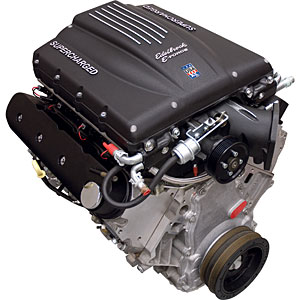

In the spirit of the STR, I'd put in this engine.
Edelbrock 46760 Edelbrock Supercharged GM LS3 416ci/ 702HP/ 658TQ - Free Shipping on All Orders @ JEGS - Free Shipping on All Orders @ JEGS
But this engine only has 720 HP!
