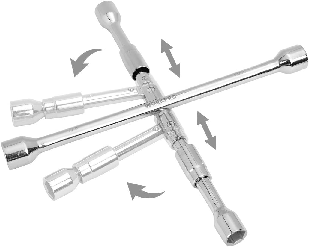

I keep one of these Fling Dung brand tool kits in the trunk:
Amazon Amazon
Nothing special, but it should get me home in a pinch. If nothing else, perhaps I could trade the tool kit for a ride home. My only gripe is the ratchet action was very coarse. I tossed it and had a spare that fit perfectly in the case. Double check the spark plug socket, too. I think the one in the kit was the wrong size. I tossed the spirit level (?) and the correct socket fit perfectly there. Make sure the socket extension is long enough for the spark plugs, but I think it was. Please note these are pretty cheap tools, so don't expect much. I don't use these as my regular tools at all. They just live in the trunk for emergency use.
One S-Type specific tool you NEED is something better than the stock lug wrench. For the stock lug nuts (steel core with a decorative Spin-O-Matic cover), get thee a breaker bar and socket that fits snugly. The stock lug wrench is aluminum, IIRC, and is a poor fit. It could easily leave you stranded. Like many others, I replaced the lug nuts (highly recommended) as detailed here:
https://www.jaguarforums.com/forum/s...al-tips-93257/
https://www.jaguarforums.com/forum/s...stions-155172/
The replacement lug nuts have a different hex size, so the stock lug wrench no longer fits. I got an inexpensive folding lug wrench that fits perfectly inside the foam insert for the spare. Remember, this lug wrench is only good for the replacement lug nuts, and is not recommended if keeping the stock lug nuts.
https://www.amazon.com/Mechanics-Por.../dp/B0CQTBBGGD
Thanks for the tip on the lug nuts, I'll have to pick up some new ones. Here's the basic kit I have in the trunk for now. It's one I bought for my motorcycle, but seems useful as a basic kit for the S-Type, I just need to round it out a bit, hence my question here.
I just went back and peeked at that lug wrench you posted the pic of. Amazon says that one's 14", but I measure the factory one in the trunk at 20". Did you find a larger version of the Workpro?
Sorry for any confusion. I only showed the Workpro version because it had a good illustration of how it folds up. The one I have came from a certain unnamed discount tool store that rhymes with Frarbor Weight. I forget the exact size but it was the only one they offered several years ago.
Another option is a socket and breaker bar. If keeping the stock lug nuts, you want a nice tight fit to grip the hex. The typical lug wrench, especially the factory paperweight, is way too sloppy and will cause the chrome cover to spin. Sockets usually have a much tighter fit and are less likely to slip. (The folding lug wrench I have is adequate for the one-piece aftermarket lug nuts.) Look around online, as you can get a telescoping breaker bar for easier storage in the trunk. Get the same drive size as the serpentine belt tensioner (3/8"?) and now your breaker bar is a dual-purpose tool.
