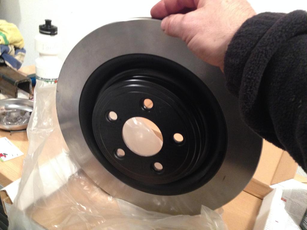

This last weekend i settled in to do my rear breaks with new rotors and pads... 1st item is to loosen all lugs prior to lifting. 1st one no problem 2nd one, frik slip slip slip.... i had a brand new set of solid ones i had bought because i had heard of the issues with the factory. they weren't going to do me much good however if i could not get the old ones off. I immediately took the car down the street to the tire shop, i had a slow leak in one , so i needed to go anyway....i had them fix the leak and replace all lugs with the new ones i had purchased.. 1.5 hrs later i was back in the garage replacing my brakes....advice....get rid of those crappy lugs, they are a terrible design and will leave you or your loved ones stranded somewhere...
