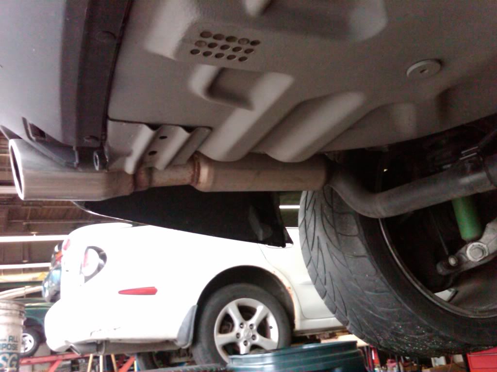

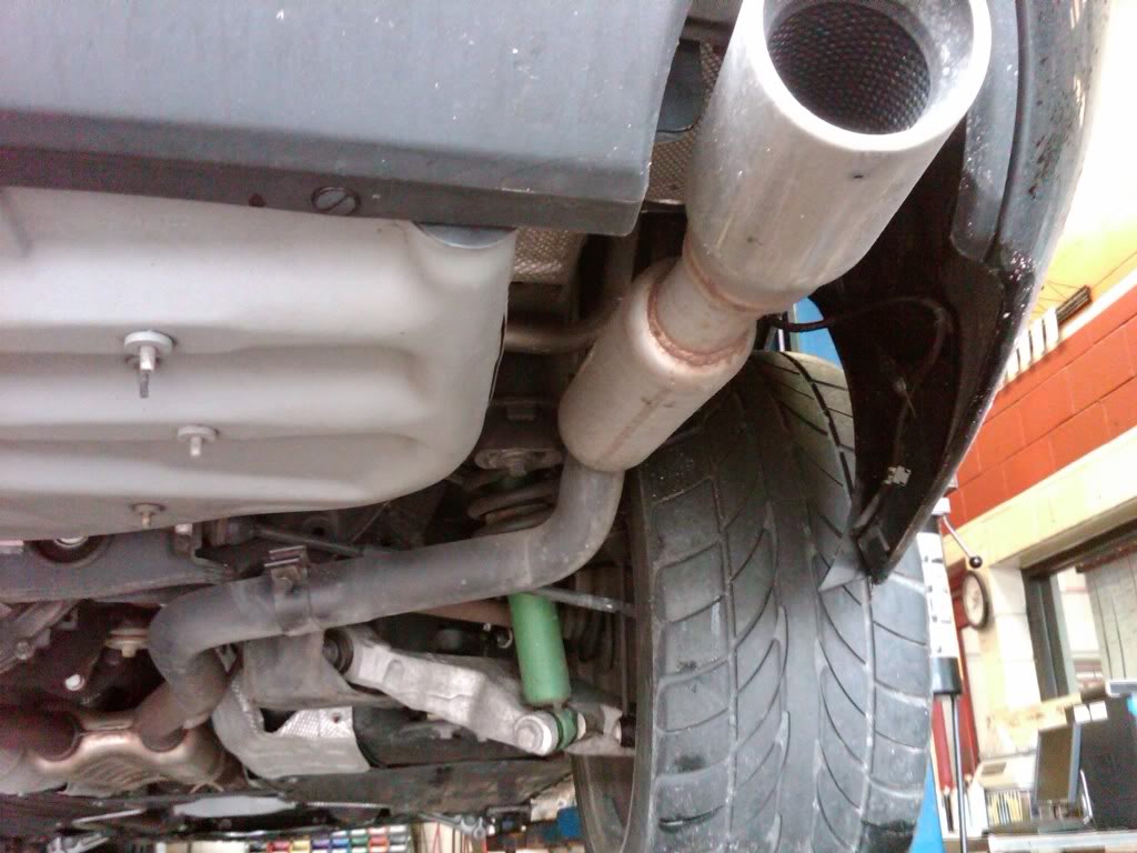

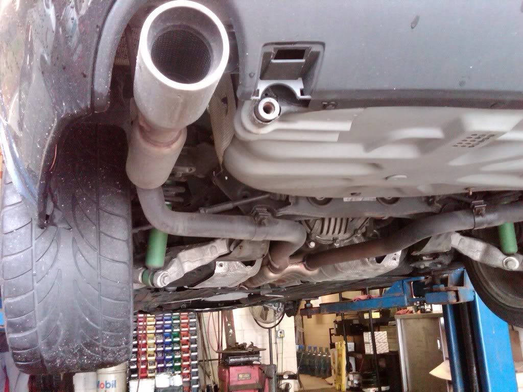

Here are some pics of my exhaust, figured i'd take them while the car was on the lift. Can anyone tell what the original owner did to the exhaust from the pics? The guy at the Tire place said that he took the mufflers off and added resonators, and whoever did the mod did a "real good job". Seeing as I dont have any pics of a stock STR's exhaust from underneath, I dont have anything to compare it to. What I can say is that it sounds pretty nasty. Just wondering if anyone has experience with this, and had any opinions.

everything is stock except the mufflers, looks like they cut off the old mufflers and used the existing pipe from the muffler back, then welded on the new resonator/mufflers and the tips. The stock mufflers are very large and kind of triangular shaped, they fill up the area behind the bumper on the sides of the trunk. This is a great way to have a 'custom' aftermarket exhaust without spending the $1k the various suppliers like to charge for the bolt-on new muffler/tip sets. If you want it even louder replace the center resonators with an x-pipe, however I will warn you the sound will most likely be very different from what you have now and not as smooth under hard accleration.

Bull, as for the mechanical aspect of the system, the welds appear to be good. As for the parts installed, well, I am sure it sounds like a bumble bee. Not the sound that I would want on my car. I bet that car also performs great at higher RPMs but just doesn't seem to have much get up and go off the line.
What are you looking to get out of the exhaust (more top end, more low end, quiet rumble, etc)? That will dictate what you can get away with and what you can't. You tell me what you are after and we can figure out the parts from there.

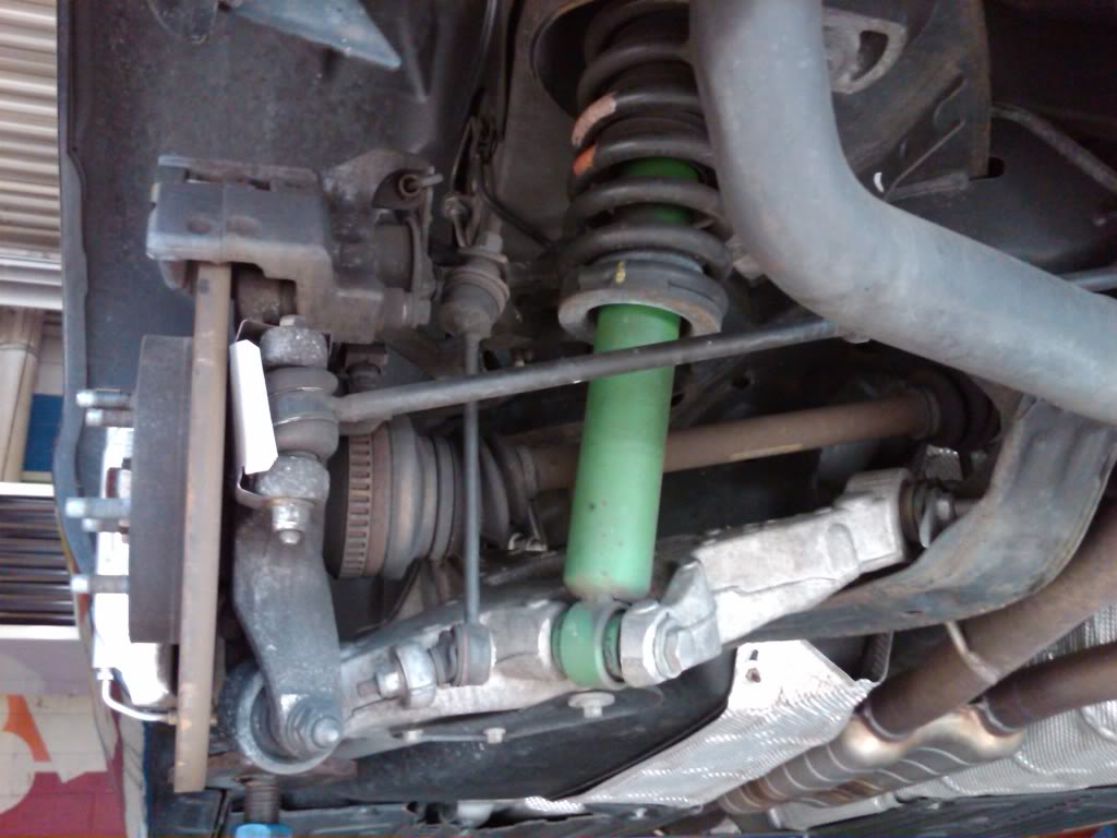

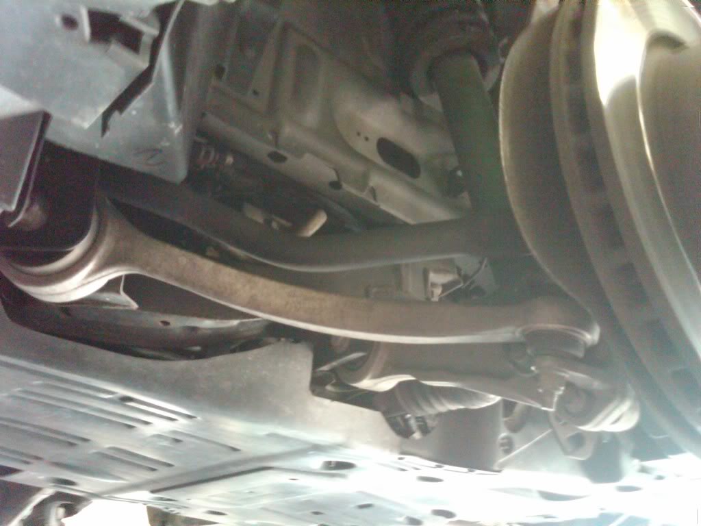

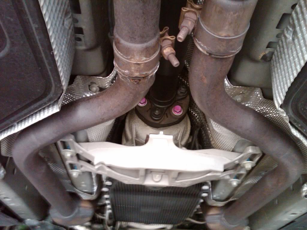

JAGV8: Here are some pics I took today when the tires were being installed, seeing as alot of the underside is covered with plastic there is only so many things to take pics of. Dont know if these will help or not?

Bull27 - thanks! Gives me some clues about what to hope to see.
