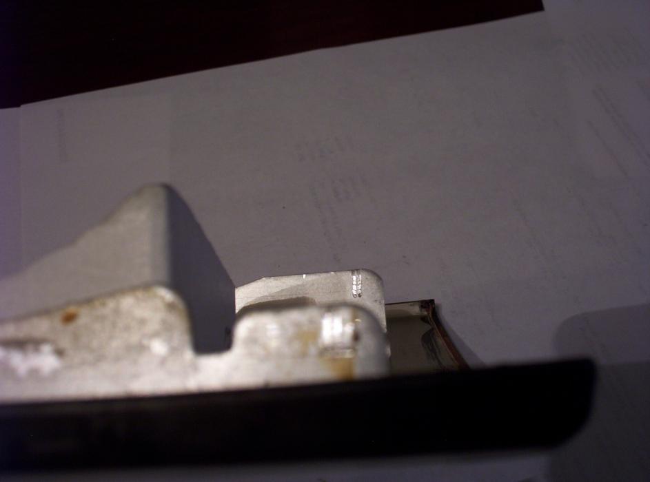

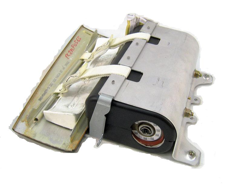

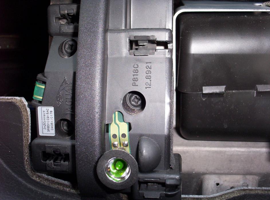

Here is a picture of the wood cover and the passenger air bag. Note the cover is tethered to the airbag so it does not smack you in the face when the air bag goes off. 4 clips in the corners. You can't get to it from behind and you must attack it from the front. I use nylon pry tools to avoid marking the wood. The wood is applied to a cast metal backing and is very strong but is flexible so you won't break the metal but you can flex it enough to crack the wood.
The wood panel snaps into black metal clips that should stay in the dash board. Most of mine did but one did come out of the dash and the clip stayed on the wood piece.
Here are the dash clips.
Here is the cover and tether.

The panel is tethered to the airbag with an Aluminum rod that is easily tapped out from either side. If you look at my pictures the rod is inside what looks like a tube on the back of the wood piece. You will need to completely remove the passenger airbag before the tether can be released. Then place the whole thing on something soft like a big towel. Especially when reinstalling the newly repaired wood so you don't scratch it. If possible another set of hands will help avoid damage to you refinished wood when reinstalling it back into the dash.
