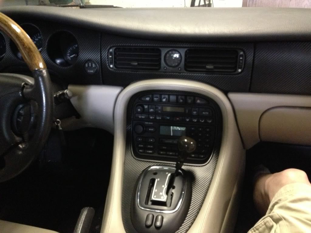

It's usually some type of shift solenoid issue or brake pedal switch problem. Does your car have a plastic plug very close to the shifter? My XJ8s have a round plug that can be unscrewed and then you stick a screwdriver or something down the hole to allow the shifter to move. The plug on mine is a start shaped thing, kind like a Torx screw.

avt the post face lift S Types do not have the plastic parts that the earlier models have in the shifter linkage. My bet is on the shift cable bolts.

You can see the hole to the left of the knob in this picture.
