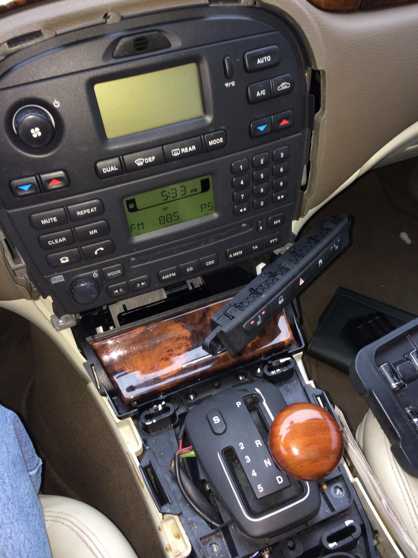

Default pic 1
pic 1

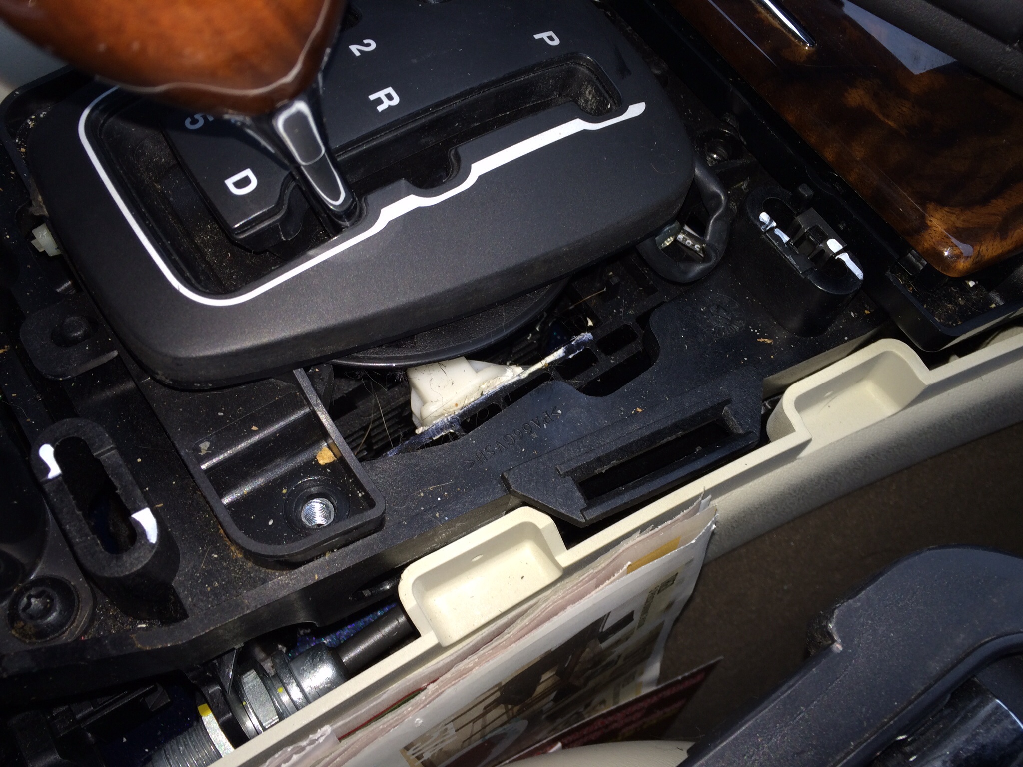

pic 2

Ok, something for people to chew on, What could of caused this and why the shifter had no power to it....the p to d now light up and so does the sport mode button...when it was locked down, they didn't light up. Someone else will have this problem in the future and it would be good to have an answer for them....Could it be the sleeve that has the tendency to leak, I notice mine was starting to seep when I was looking at the linkage. it had a lot of wires going to it. If I was making a guess, thats the one thing that could of knock the transmission out of service....Any thoughts??????????

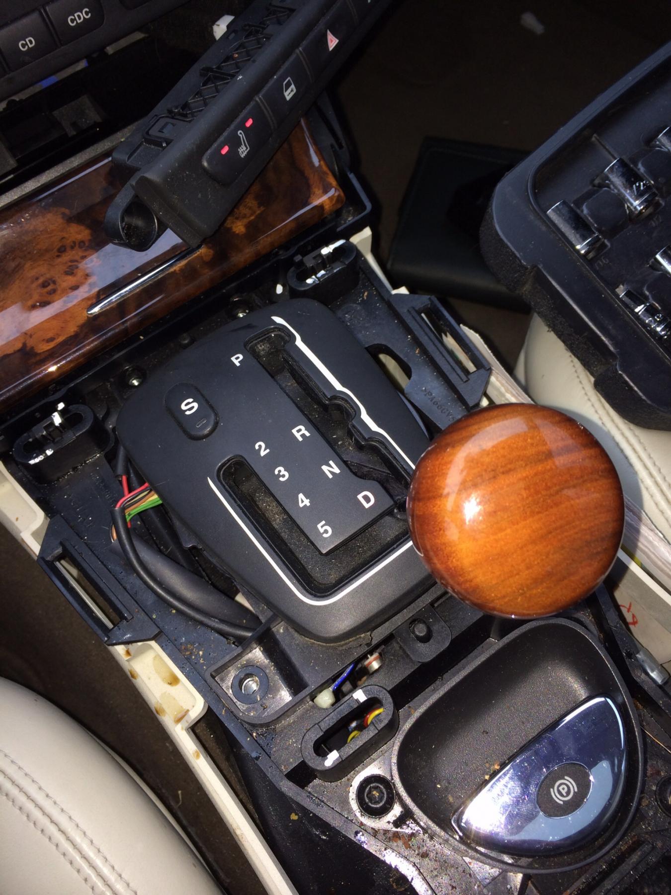

pic 3

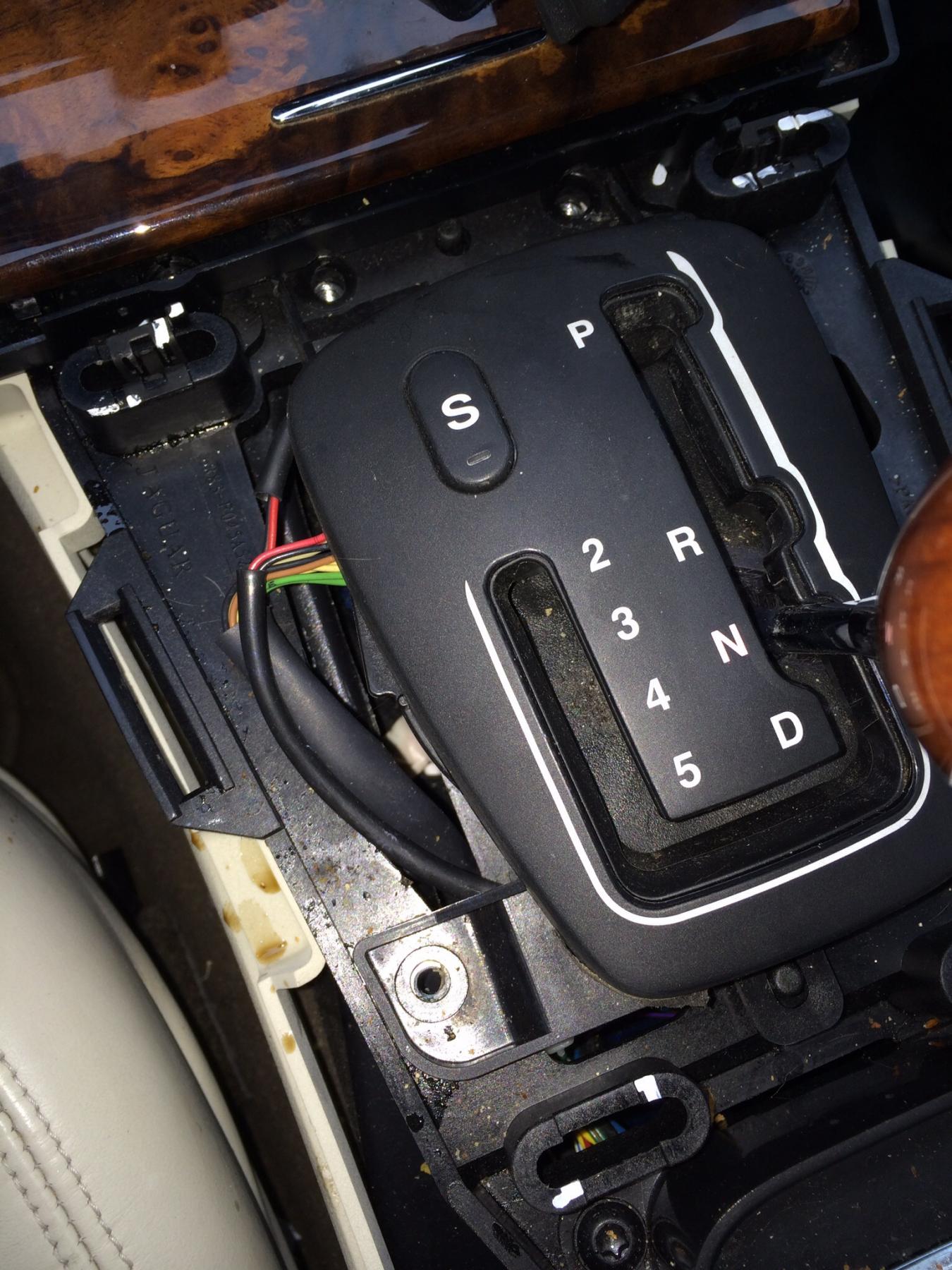

pic 4

Good news, but you didn't actually find anything?
Maybe a bad connection that you moved when you pulled the surround off? Give everything a good shake while you have it open.

Next question, are your brake lights working properly when the shifter won't release? I think the same circuit that powers the brake lights is also tied to the shift release solenoid. If water from the carwash got into the brake lights, you could have a partial short to ground, diverting some of the current needed to actuate the solenoid. The brake lights may come on but not as brightly as normal.
