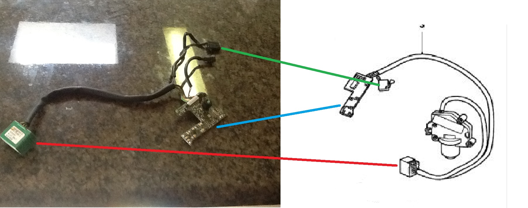

This is what caused all my issues, the circuit board in the picture.

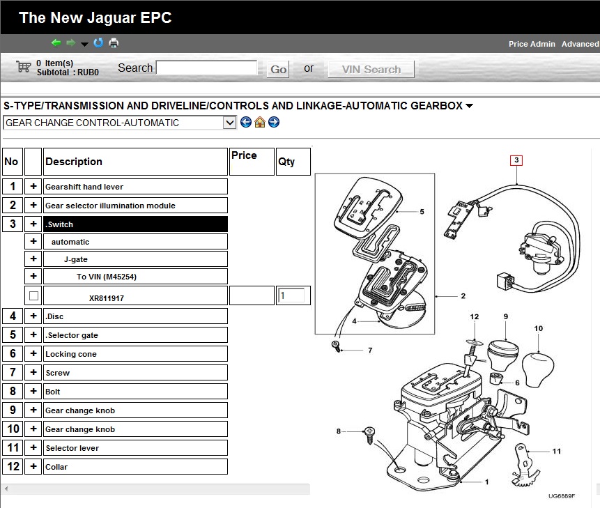

For anyone else who travels this painful route, it looks like the Switch (item 3):

Looks like Fig 04.1 in Electrical Guide.
The Not-In-Park switch?

SNG Barratt - The Ultimate Jaguar Parts Specialist, this is the site for the part

It's the electrical guts of the shifter, a microchip went out causing the issues, the silicon board was produced in February 2007. It contains the lights and all controls to the shifter.
