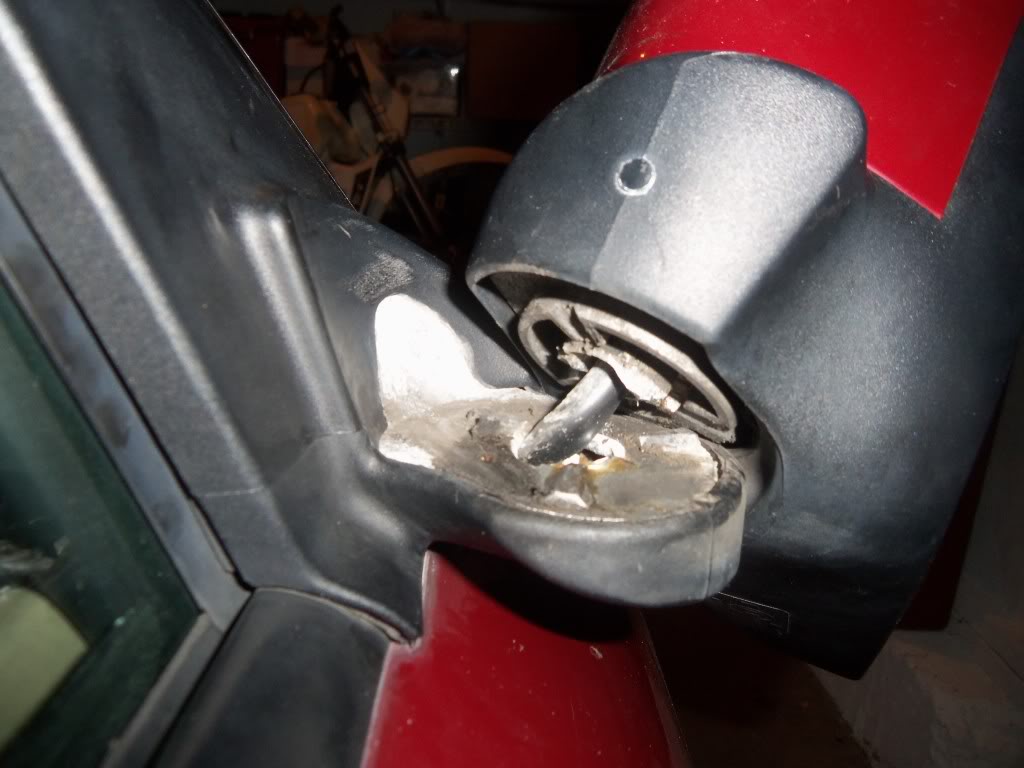

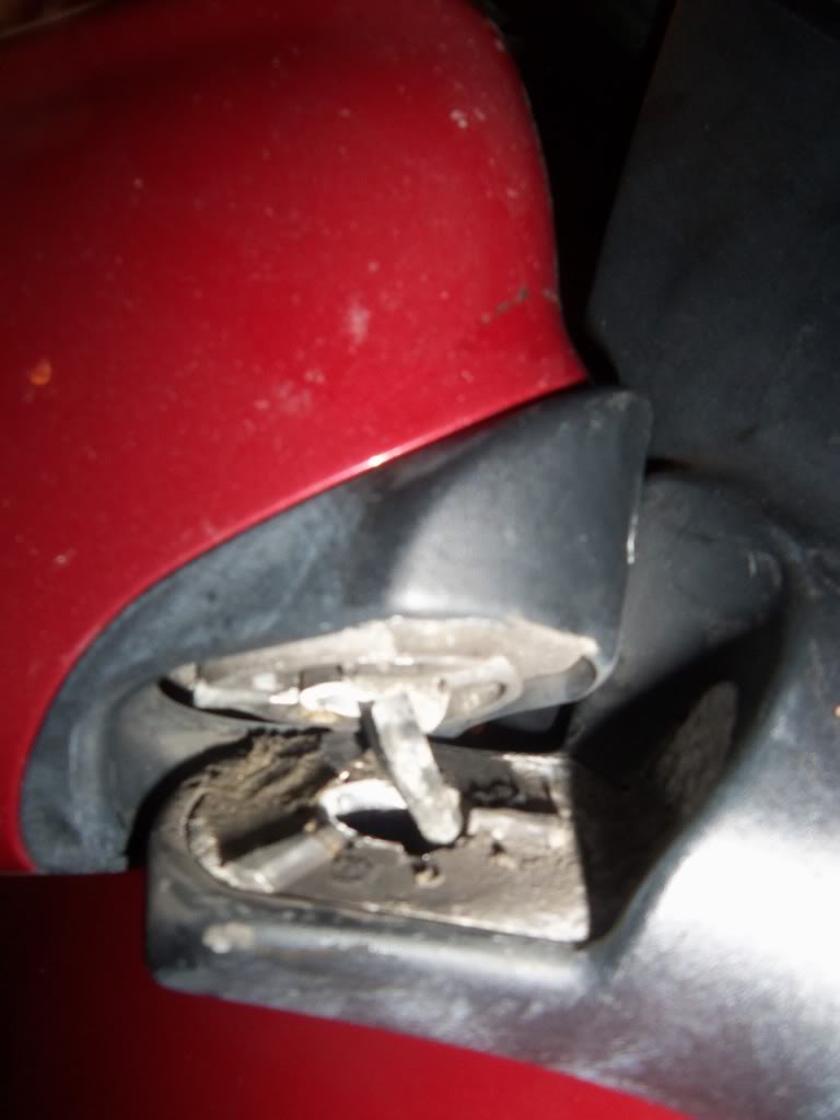

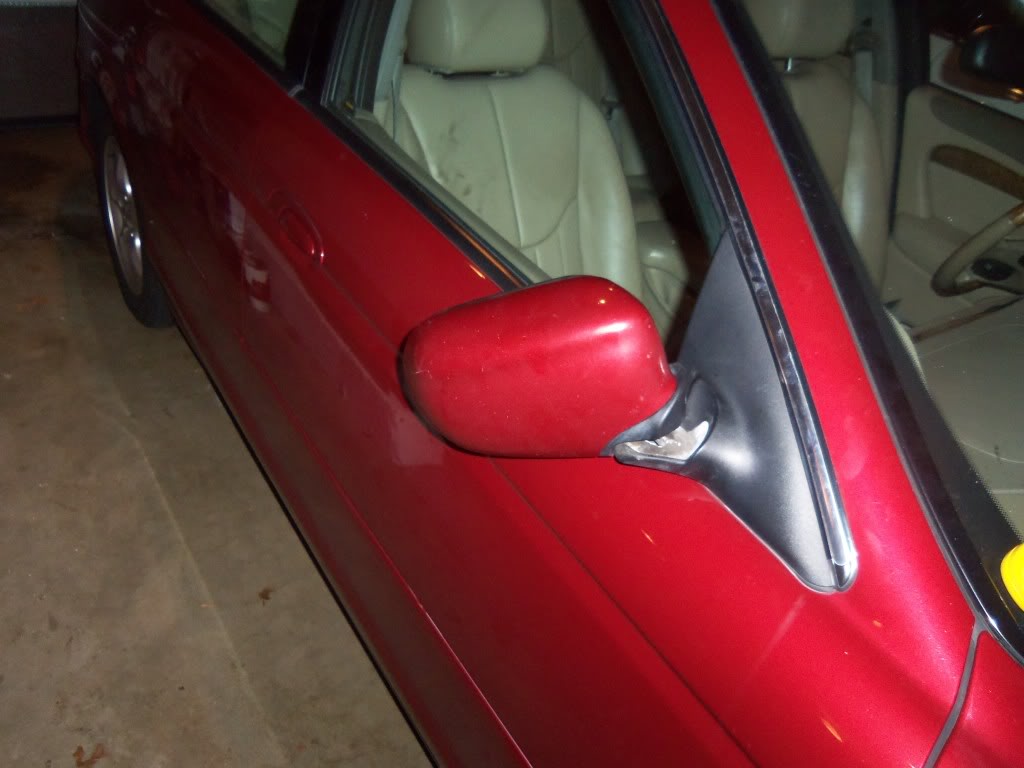

Hey guys, I am new to the forum today. I am trying to fix my mother’s Jaguar mirror. It’s a 2000 S Type. Somebody hit it with their car door. I have included pics below. I am wondering a few things…..
1. Do I need to buy an entire mirror or can I just replace that hinge piece that broke?
2. Anybody have a mirror or hinge for sale?
3. If I need a new mirror, how do I get to the bolts and plug from the inside of the car?
4. The glass and colored part of the mirror pop off right?
5. How can I tell which mirror I need? I noticed there are a few options, heated, powered, memory, etc. Im not sure what this car has. How can I tell?
6. Is the X type mirror complatible?
Thanks in advance for any help. Looking to fix ASAP.

Hey sorry to hear about your cat but if you can find a salvage yard that have new model cars and see if the have your Yr make and model and if it's in good shape you can use the back plate from yours on it that way you don't have to try to find one your color

thats my plan, except i will buy one from ebay. they are about 100 bucks. my question is,w which are compatible....
i will call the dealer today and ask them. thanks

If it's a 1999-2002 car you need another of that range as the mirrors are squarer than the later cars. You could download and consult JEPC.......
