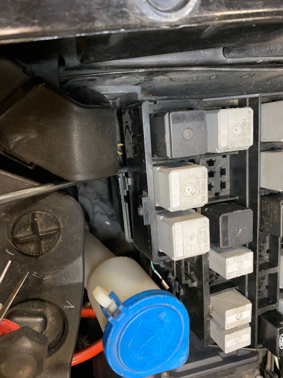

Anyone ever remove the fuse box and/or open up the fuse box (split the top from the bottom)? I have a terminal for one of the relays that got pushed in and its no longer making contact with the relay pushed in so it no longer makes connection with the pin on the relay
I thought I could grab the end of the terminal and pull it into place but it wouldnt lock in place and now its down way too low to grab. I also went around the box and undid the little plastic latches that hold the top and bottom of the fuse box together but the two pieces wouldbnt budge

I figured it out. Pretty obviis when you loom at it. Tabs all the way around it hold the op to the bottom. Then there are 3 tabs holding the bottom to the mount. Just a pita to get it open and get the pushed terminal back in its slot. There was much cussing
