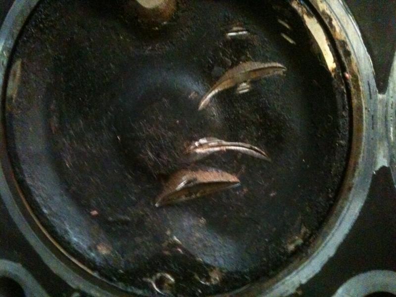

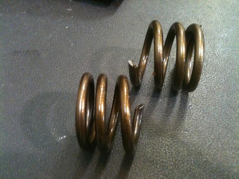

Thanks for your posts but as strange as it seems that's what actually happened. My wife has also been around me long enough to know if she there was any obvious problems with the car she would pull over immediately hence the reason she called me as soon as the check engine light came on. Anyways, the dealer has already taken the top of the engine apart (he was hoping that the damage would only be limited to the valve since my wife had brought it in immediately) and sent me the pics: broken valve spring, broken valve, and damaged piston with two marks on the piston head where it contacted the valve. The dealer thinks the compression from the engine kept the valve from falling through until my wife turned off the car when she arrived at the dealer.

Thanks for all the information. I'm still sorting out all my options and will let you know what I eventually do. In the meantime here are the pictures that the Jaguar dealer took for me.

Thanks for posting the pics, and sorry it was your car that was blessed with such a rare event. In looking at the fracture surfaces of the valve spring, it seems that the dealer's diagnosis was correct.

If there is no hole in the piston, take the risk with one new valve and put the lot back together.
I bet it will run fine again

Is the head damaged? With the head of the valve separated from the stem I would guess it hammered the combustion chamber and maybe ruined the valve seat?
The piston does not look bad. I would smooth the top of the piston as much as possible then replace what's broken in the head and put it back together.
I have seen much worse and it ran just fine. The correct used engine did just pop up on Ebay but it is $4500.
