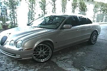

Okay..as the title states..I am a new owner of a 2000 jaguar v8 4.0 S-Type .
Beautiful looking machine..Just need to get it running and feeling properly. Heres a list of things that were stated from the previous owner that needed to be checked:
a) coils need to be replaced
b) heater needs sensor (i have no clue)
c) front rotors need to be replaced at "some point"
Here's what I found out...
a) a/c does not work (fans dont even kick it. made a short quick whizz noise then absolutely nothing)
b) heater doesnt work either
c) all rotors were overheated...back wheel bolt was broken in half
d) all brake pads are worn
e) sputtering engine feel..aka "the dreaded misfire".
Too scared to floor it even moderately because of the hiccups/misfire.
f) check engine light comes on every now and then
I just want to get this car running properly so I can focus on all the fun stuff.
The estimate to completely redo all the brakes was 1209.00 ... seems a bit outrageous but not sure. This was coming from a local discount tire shop and they said the price was hiked due to the harsh condition of the rotors (all 4 overheated).
I'm really scared to find out all the "hidden/unexpected surprises within the engine portion as well..
Does anyone know of any reliable jaguar/knowledgeable mechanics in the Los Angeles area?
What are the initial steps I should take to get everything checked out properly in terms of seeing what is wrong with the car? (which I should have clearly done before purchasing)
The car came with aftermarket rims. (MHT 20"). Tire spec is 225-35-20. I really admire the look but am wondering what classifies performance as well as the look? Anyone here riding on 20" rims without rubbing? Is arch rolling bad for your vehicle?
Thanks guys..hope to be getting this thing up to par fairly soon. Sorry for the novel/20 question interrogation! lol
