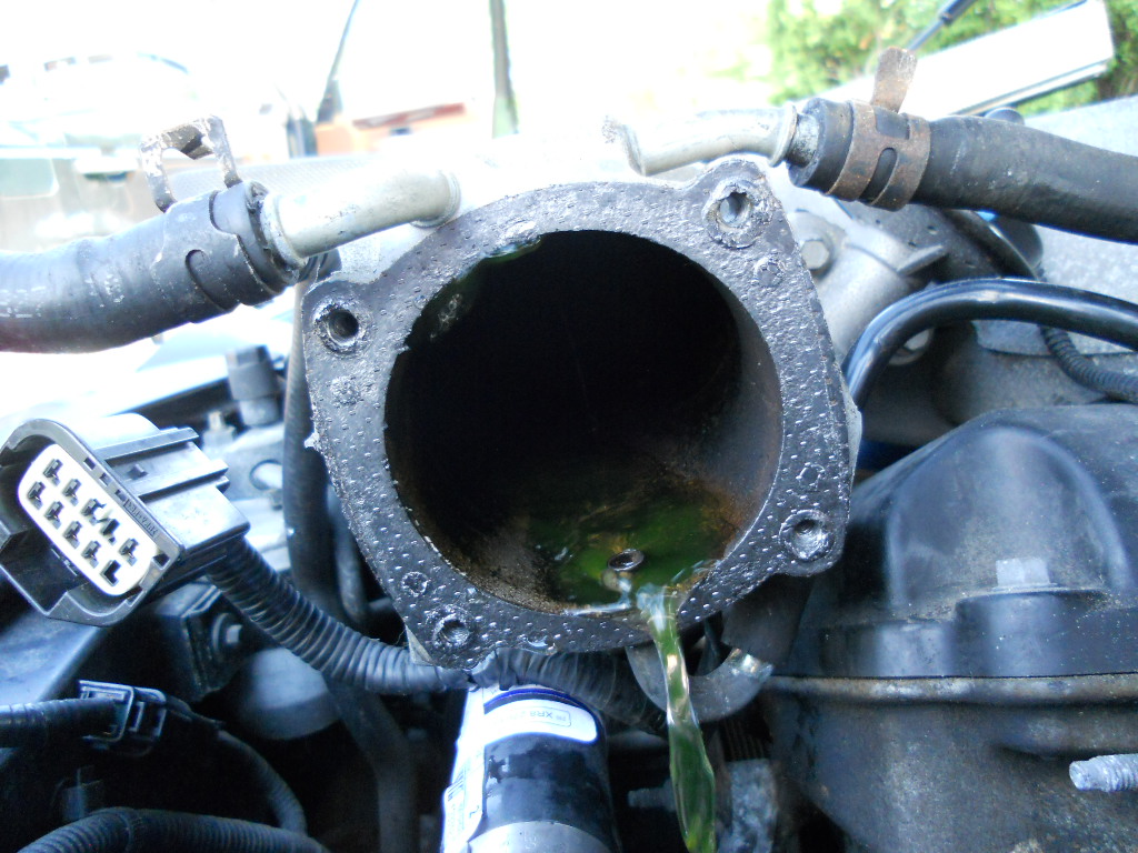

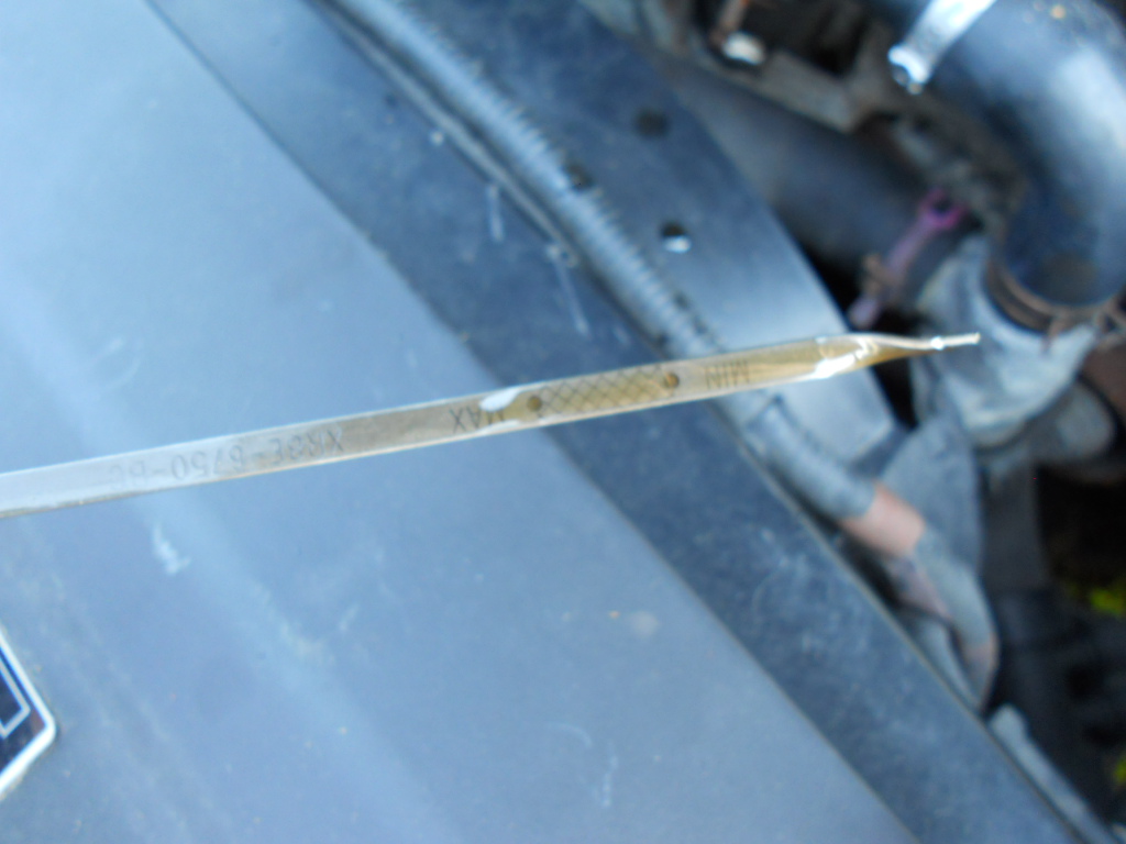

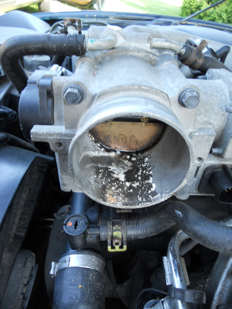

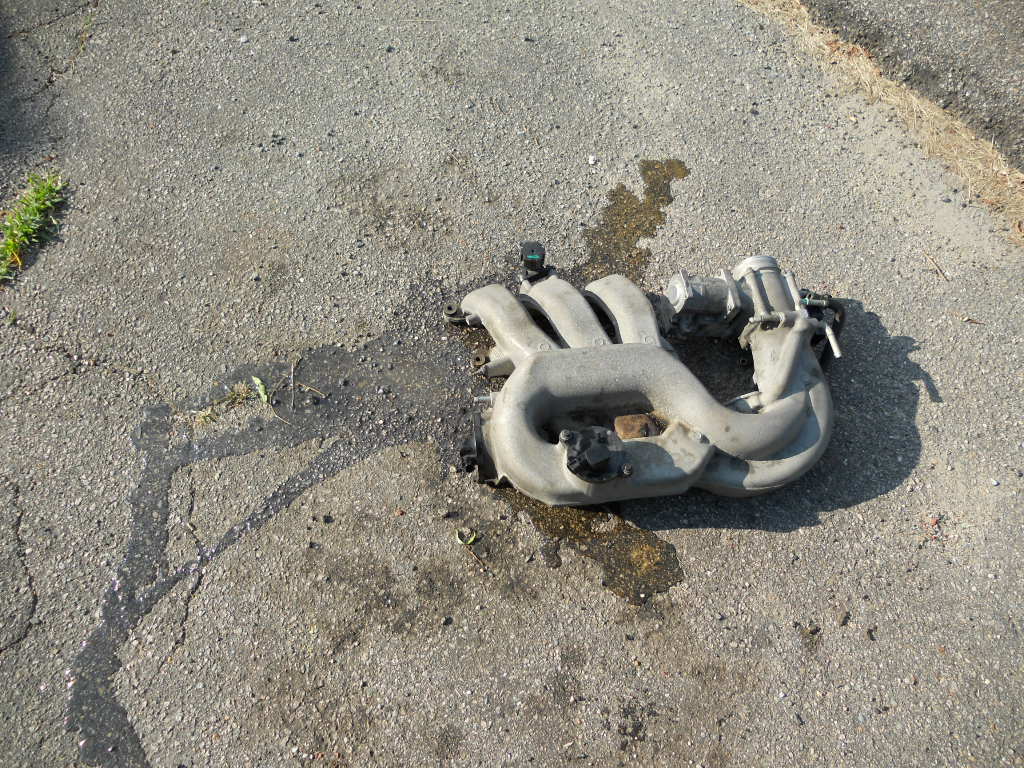

let try a show and tell, new to site and posting pix sorry if I wait your space.
pix 1 is drip stick over filled with oil not water
pix 2 throttle body
pix 3 throttle body under pressure
pix 4 upper intake draining
pix 5 lower intake

I do another question for any body or there on picture #3 that coolant is actually pouring down from the top of the throttle body, the coolant appear to be running into the plunum from the recovery bottle vent?

There is apparently a leak path from the cooling system into one or more combustion chambers. If an intake valve is open, any fluid pushed into the cylinder will flow back out the intake.
Old Jun 18, 2013 | 11:42 AM
  #36
drowssap's Avatar
Posts: 39
From: ma
I believe you are misunderstanding me the water did not come back up the plenum. it rain straight down from the top of the intake.
I stuck my finger in the hole it was backing up from the recovery tank. in the 2nd picture it is the hose on top to the right.
I know in the pix it look like it is on the floor of the intake it isn't, it hard to pump and take a pix at the same time.
I "believe" hydro lock was never a problem. I think all that water got in there while pressure testing after it cut out on safe mode.
Don't forget I my first post I said I was running it without a belt to eliminate any of the accessory pumps as a cause of the noise.
So no belt, no water pump, engine acts like a heat sink and goes high enough to trip safe mode.
