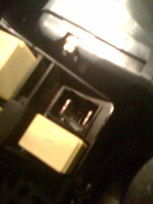

I contacted a local Jag parts house and have never heard of that 80 amp cooling fan fuse being replaced and even suggested that there wasnt one. I had him look it up in the manual and eventually agreed that there was one.
Could anyone look at thier front fuse box and confirm that they too have one installed on a 2000-2001 or 2002? I am attaching a pic. You can see that it does have two male prongs that something attaches to. According to the manual, it is the cooling fan fuse.

Those prongs look rather like the relay has been pulled out leaving behind the broken off prongs. Don't rip them out without confirmation!
If you do remove them, don't short anything out as you do it.
The 80A fuse can be seen here
www.captainjaguarscathouse.com/Electrical_Guides/
just click on Power Distribution
Fig 01.1 at the top right.

[quote=jagv8;294817]Those prongs look rather like the relay has been pulled out leaving behind the broken off prongs.
I thought so too but they are acutally built into the fuse box I noticed similar male prongs on the smaller fuses along the top of the box, almost like a bus bar.
In person, you can see grooves where something had been slid on over them.

try to switch it with its neighbor you are just testing, anyways jsut make sure its close in amperage and a non essential fuse.

I think there's only one 80A fuse, so none to swap with.

60A should work as long as a non essential function,
Although those fuses can be found at NAPA or autozone or local parts store.

You are correct, there are no others to swap with..... I looked. I hope that when I do receive it and install it, it doesnt blow. Just thinking ahead...that would mean a short in the wiring. Could the fan module going out cause a fuse to blow? I just dont know why anyone would take that fuse out........unless someone blew it.

If you have a multimeter you can test for a short before installing the new fuse.
Either put the meter on continuity and probe the two tabs in the fuse box, or if no continuity setup put it on the lowest ohms setting, if there is a short it will be at zero or damn close.
A bearing or brush the fan motor can also create an undue electrical load and blow the fuse.
It's going to be very low ohms (a lot less than 1), especially if not spinning (so no back EMF), isn't it? Easy to confuse with a short, I'd think.

Er, is that right? As I read the circuit diagram the fan is driven by the module (probably PWM).

IF there's a wiring short that's causing the fuse to pop, then it will show as continuity or low resistance. You're probing to the module (when you probe across the fuse) , not the fan's motor directly.
You're right about the 2nd part. The Module is driving the fan. I for some reason though PCM - which just sends the enable to the module. Sorry about that.

Alright, help me to understand what I just read off the multimeter (I'm a Virgin). Set it to 2000 ohm. Placed a probe on each side of where the fuse would be. It generated a value of 1080 and kept climbing.
Disconnected the harness at the fan control module. Set multimeter to continuity. Set one probe on the no voltage side of the fuse and the other on the end of the wire. Multimeter went from 1 to 000. If im reading it correctly, there is no short and has continuity.......right?
With the harness disconnected, I did the same thing with the fan motor itself. multimeter set to 2000 ohm, value went from 1 to 002. Set the multimeter on continuity, value went from 1 to 002 and 001. It didnt go to 000 like the other. What does this mean for the fan?
