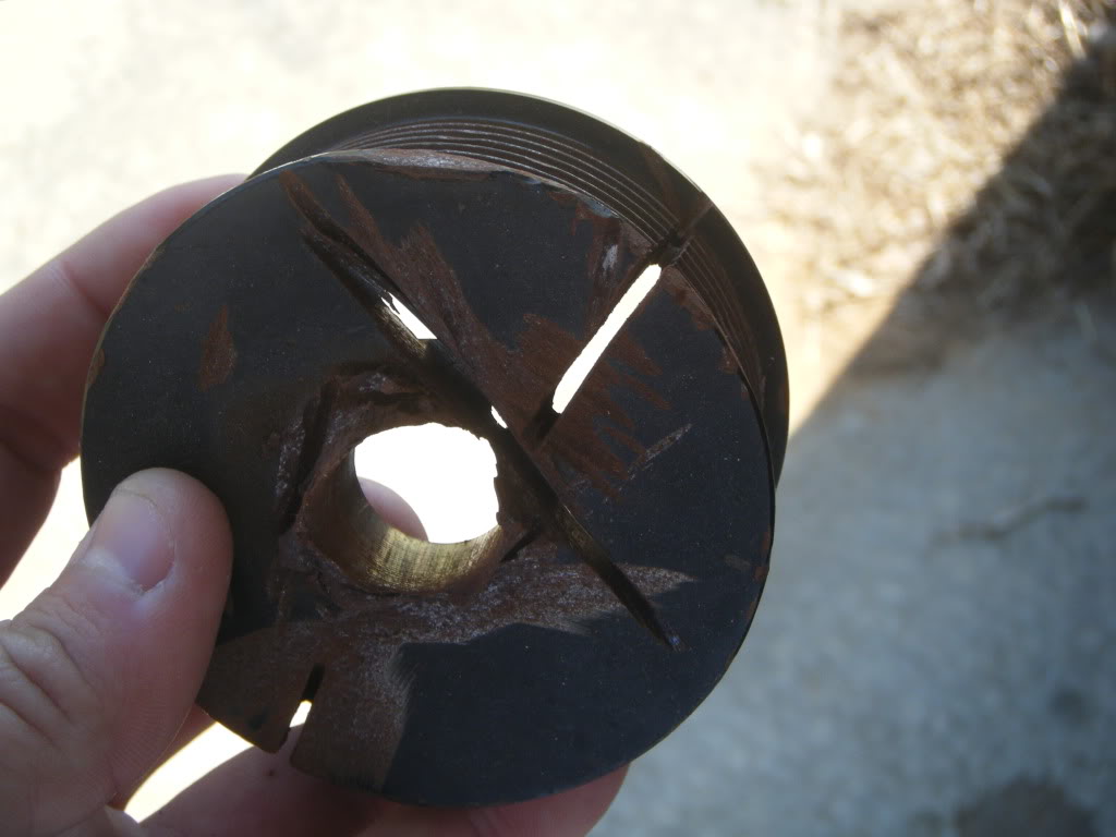

Not sure on the clearance of the puller. I installed mine but cut off my stock pulley. If I had the puller I bet I could of done it alot faster. But then again I dont know how the puller mounts to know if there is enough room. I did my install on a Sat and was driving by Sat night. Thats with about 4-5 hours of cutting. As you can see I had to make a few cuts. I also didnt have a smaller dremel style cutter which would of definitly helped. I had a larger die grinder with cutting wheels which made it a little more difficult. I did rent a puller but it was just a standard puller which couldnt bite the pulley good enough to pull it. To use it I did put a jack under the motor and just slightly lifted it just about a 1/2" which I was able to do without unbolting it from the mounts. The play in the engine mounts were just used. How much more room you would need with the special puller I dont know. It doesnt take long to get access to the pulley so you may just have to get in there and play around with jacking if you dont get the clearance just taking the slack out of the mounts then you can just put it back together if you dont want to do the cutting route. If you do this dont forget the coolant cause you have to remove the reservoir. If you have anymore questions let me know. I'll try and dig up some of the footage I have for the video I was going to make untill I got to cutting then it became more about getting the dang pulley off then about video so I only have up to that point.

fergs03str, I began with a Mina 1.5 lb. pulley and it was great. Prob. worth 20 hp alone, 30 hp with intake and exhaust mods. As vance580 remarks: The stock steel pulley can be cut to facilitate a shortcut rather than jacking up the motor to make way for the pulley puller. Due to a bad case of HP addiction...the 3 lb'er. A much lower labor charge caused the 1.5 to be cut. The pulley was gifted to Vance580, so I bought him one for kicking *** in Iraq (I learned he partied and slept through most of the ordeal) The 3 lb'er is a hoot! The low temp. thermo, removing the plastic vanity cover off the s/c, and hi-flow cats likely lower blower and motor temps. for longer power trips before heatsoak sets in. A "Chiller Killer" or methyl-alky kit would be the icing on the cake for long term intercooler "Cool Downs". I'm estimating the mods cause her to crank out close to 460 chp @ 500 lb/ft trq. Go for it bro!
