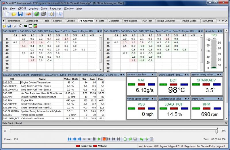

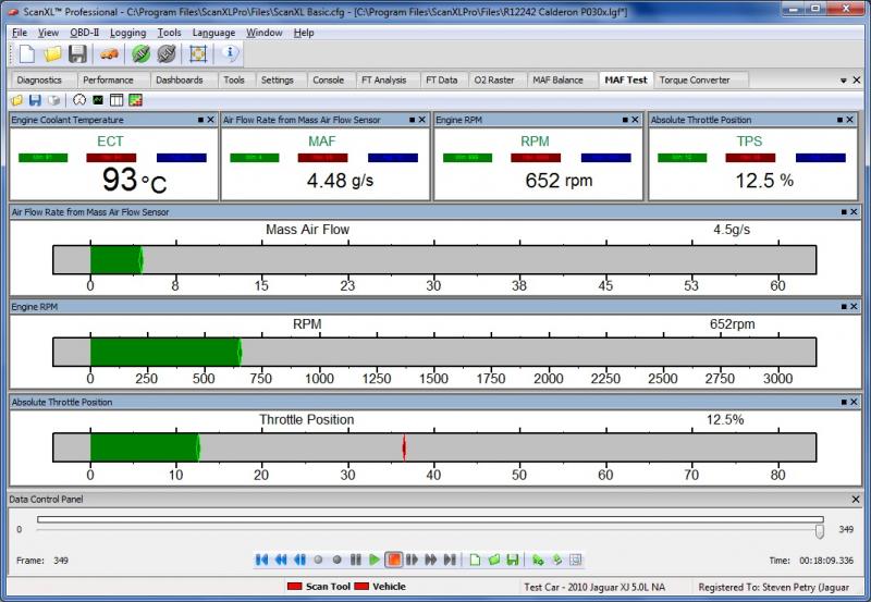

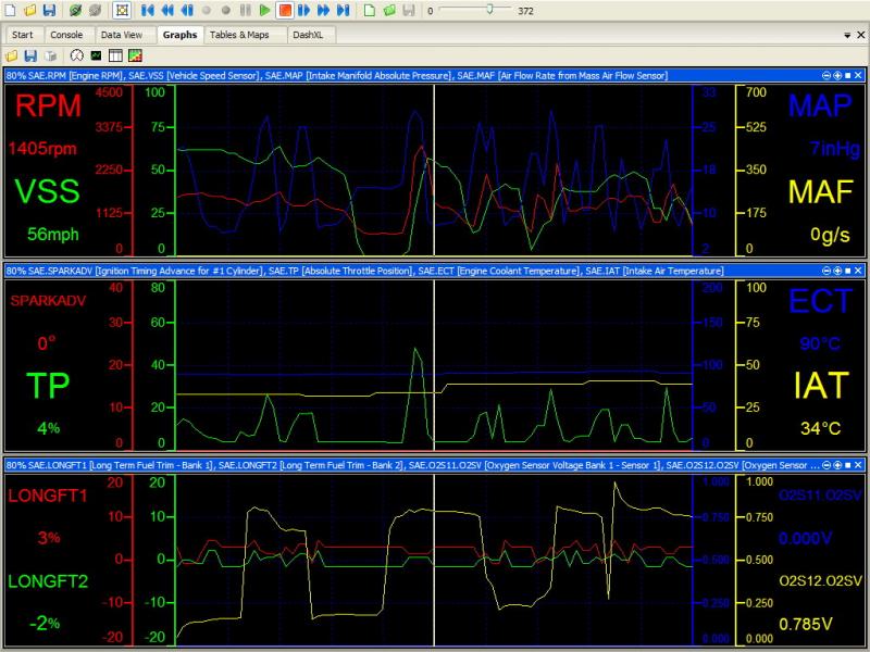

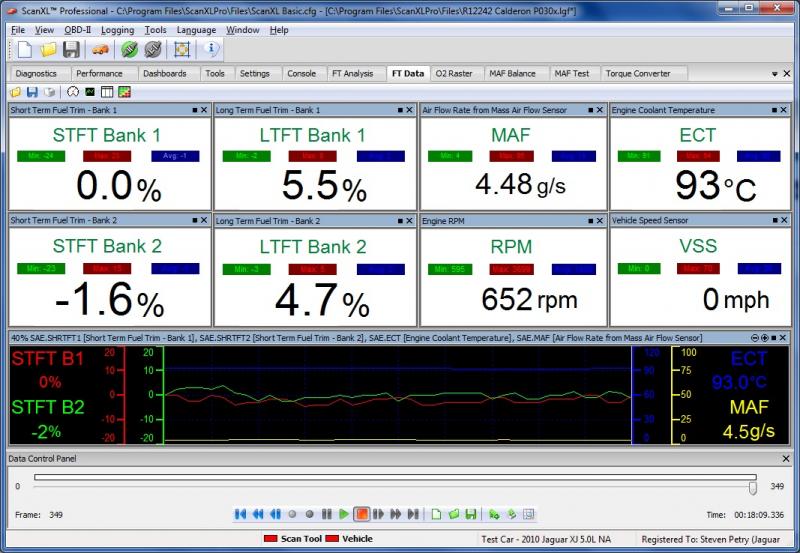

For $99 and your bluetooth dongle you will get a whole lot more with Palmer's ScanXL standard. Dash Command doesn't do graphing, freeze frame information, O2 sensor tests or read calibration ID's. It's mostly for the pretty Dashboards you can make; though it will read and clear codes. And that's all bluetooth. So it depends on what you want out of it.
Pics show it's versatility.
