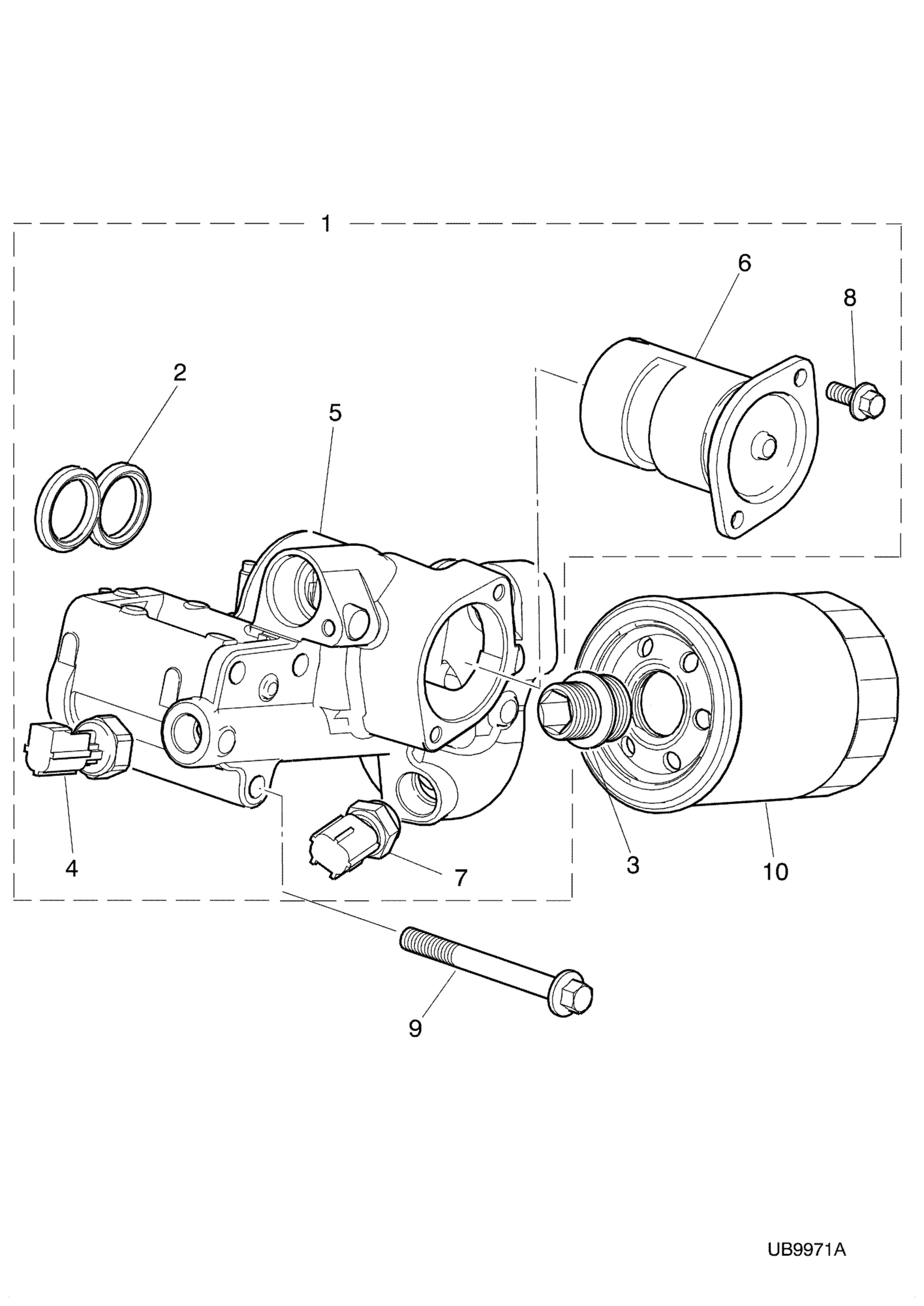

Does this parts diagram help? Perhaps gasket #2?:
https://parts.jaguarlandroverclassic.../brand/jaguar/

Thanks for all the help.
The metal line connecting to the oil filter housing above the filter has a o ring seal that I replaced. there is still oil coming for somewhere but this stopped the majority of the leak....
