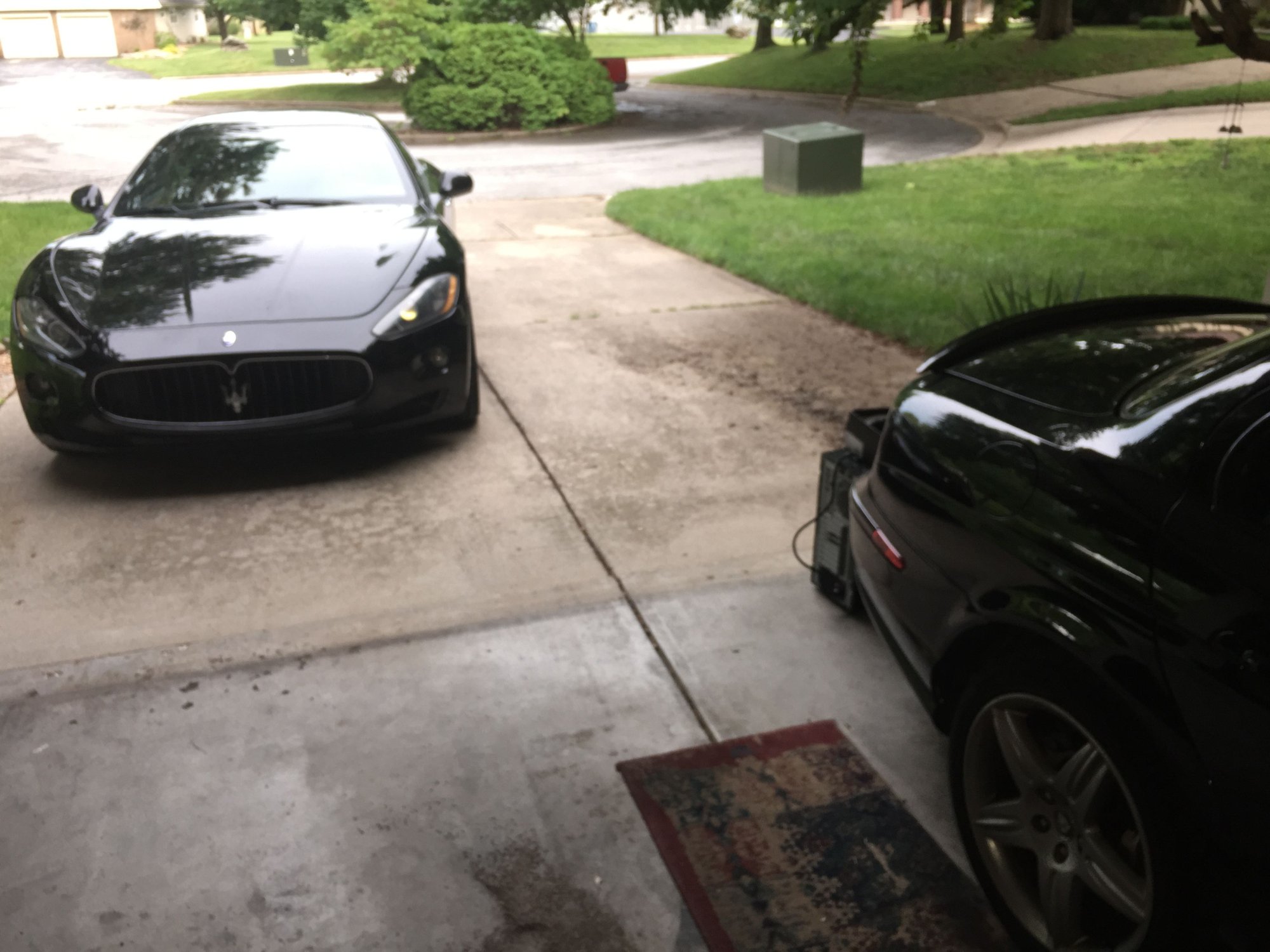

as far as 'explaining' and 'doubts' etc:
there ya go. xoxo.
