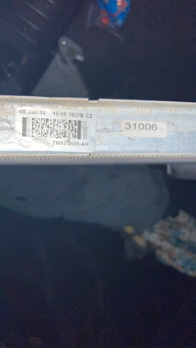

I drove the car to my buddies house, it was running fine on the highway until i pulled into his shop, we are looking at the car and boom 4 minutes into it the water started pushing out the Coolant tank, it was boiling over, don't know if i need a new reservoir or not. But okay, pulled the water pump out, the impellers look fine they are still intacted, ill order an airtex one because the ac delco one only had 5 bolt holes not 6 and so i had to return it. I had the time to go ahead and remove the radiator, should I just get it flushed? I saw a date on there included in the picutre (08 Jan 14) is this 2008 January 14th? or January 8th 2014? I had the chance to remove the DCCV and the Electric water pump on the fan shroud. I'll check the pump flow by wiring it (12 volts) to it and run it thru a tube of water. The thermostat has been changed but i'll check it with a pot of water that is boiling. i took off one of the bleed screws on the intercooler right side the small one and it broke off i need a new one anyone has a part number?

I think it increasingly looks as if you have a problem with a head gasket(s). You most likely have exhaust gases escaping into the cooling system. Because the exhaust pressure is much higher than the cooling cap pressure, it forces water out and eventually overheats when there is too little, or, the water is sucked into the cylinders ans the result is the same.
The radiator date is far later than the car, so someone must have had problems in that area before.
