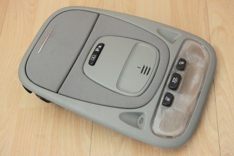

If you've the front parking sensors there's an OFF/ON switch in the overhead console.

Hmm hadn't noticed that I have it. Will certainly look for it when I get home. Thank you for the quick response.

It's got a P on it & turns off both front & rear.. They only appeared in cars with the front sensors fitted.
EDIT:- Added photo.

Just checked. The console doesn't have it.
Now either the previous owner replaiced the console for one without the button or the car doesn't have front sensors.
​​​​​​But i think the few times the system worked i remember it beeping for obstacles in front of the car.
