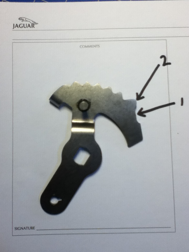

I first became a visitor to the form when I was having stuck-in-park issues with the S Type. After deliberation and procrastination and many many visits to the forum I made the decision to have a new parking pawl installed by the dealer in my closest major city - Perth - the company is called Roadbend, third generation family owned business and quite good to deal with.
I had the pawl installed, the transmission serviced, the drivers window winder replaced and the headlight shells polished. All good til yesterday when the stuck-in-park thing reared it's ugly, useless, frustrating, revolting head again. All day I had been in and out of carparks, and sometimes it would snick itself out of park like a thing of beauty, and sometimes it felt a little rough. Almost sounds like an adjustment issue somewhere but where oh where?
Then on the penultimate park of the day, I had to park on a gentle incline, so gentle that when it did it's thing, I had no trouble at all gently rocking the car back and forth. To the degree that I could hold it pushed forward and reach the foot brake to hold it there with no trouble. With the foot brake on it eased out of Park like it was nothing. On the very last park of the day - at my local liquor shop for a bottle of Jose Cuervo - I decided to leave the handbrake on whilst moving it out of Park. It was a flat surface, and the lever came out easily and smoothly. Perhaps taking the handbrake off before moving the lever out of Park gave the car just a little movement, enough to jam the pawl. Even with the foot brake on.
I religiously do the footbrake-neutral-handbrake-park movement, but to no avail in this instance. I am a bit sad this is still happening. My dealer assured me all else in the transmission is fine - cables not stretched, quadrant in fine condition. Ah well. We'll see how it goes. If it continues, it goes.
Thought I would attach a picture of the old parking pawl for those who have no idea what one is or what it looks like, I know I didn't. Number 1 is where the pawl sits when in park {against a pin, that rotates as the pawl is rolled over it I would assume?}, number 2 is the lug that has to slide/roll over the said pin when being taken out of park. The dealer said that on the replacement pawl that lug is smaller. Makes sense. He looked faintly horrified when I suggested that I would've just ground it down on the bench grinder! Just kidding...

The Jag dealer also gave the previous part number for this solenoid - XR811917. Might help someone else trying to track this part down. He quoted me $526 +GST ex UK, pricey huh?
At least I can use the car, at the moment she is a beautiful piece of shed art...
I'll be back in a week or so with hopefully more info after I've spoken to my autotrans guy and his magic satanic multimeter..
