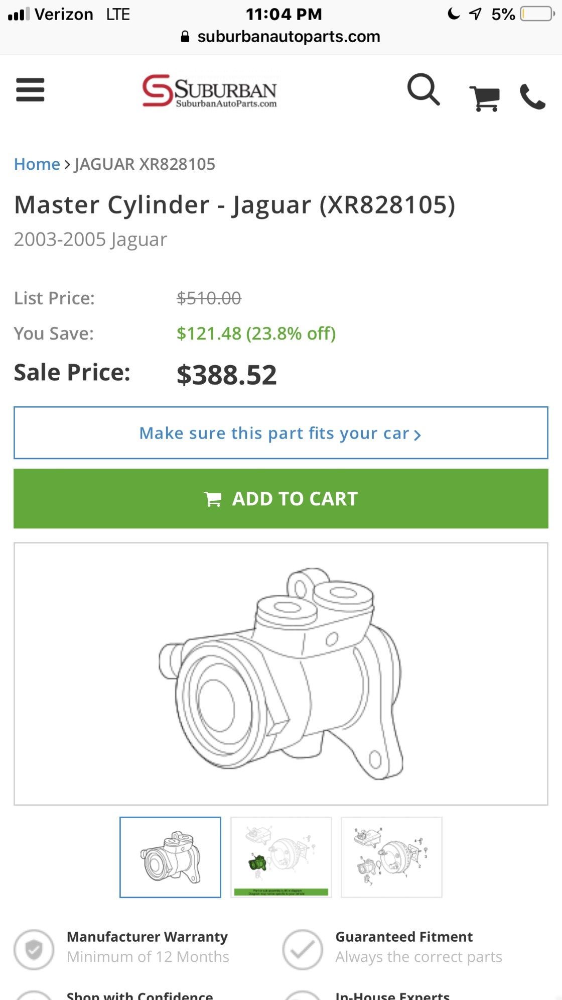

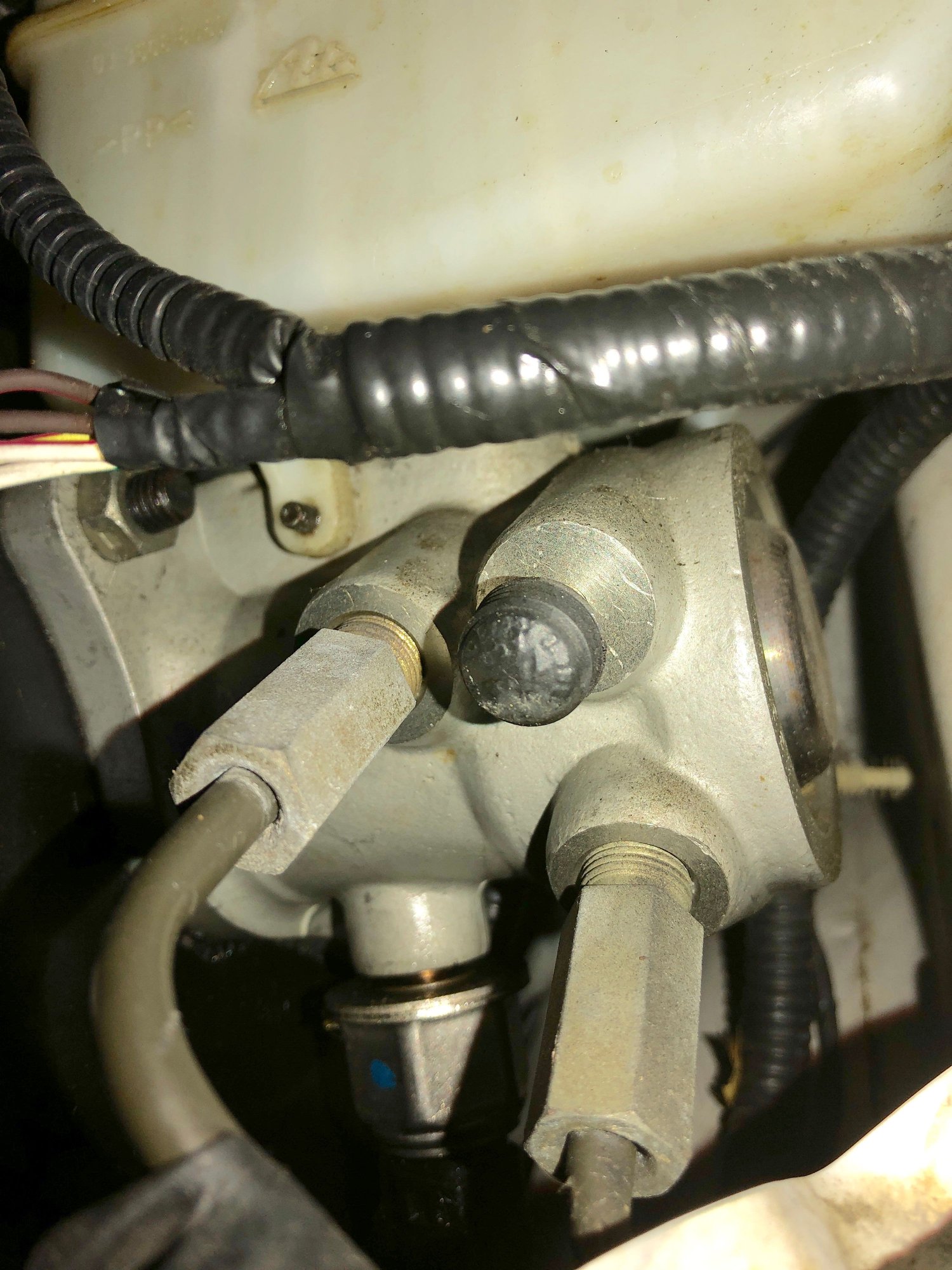

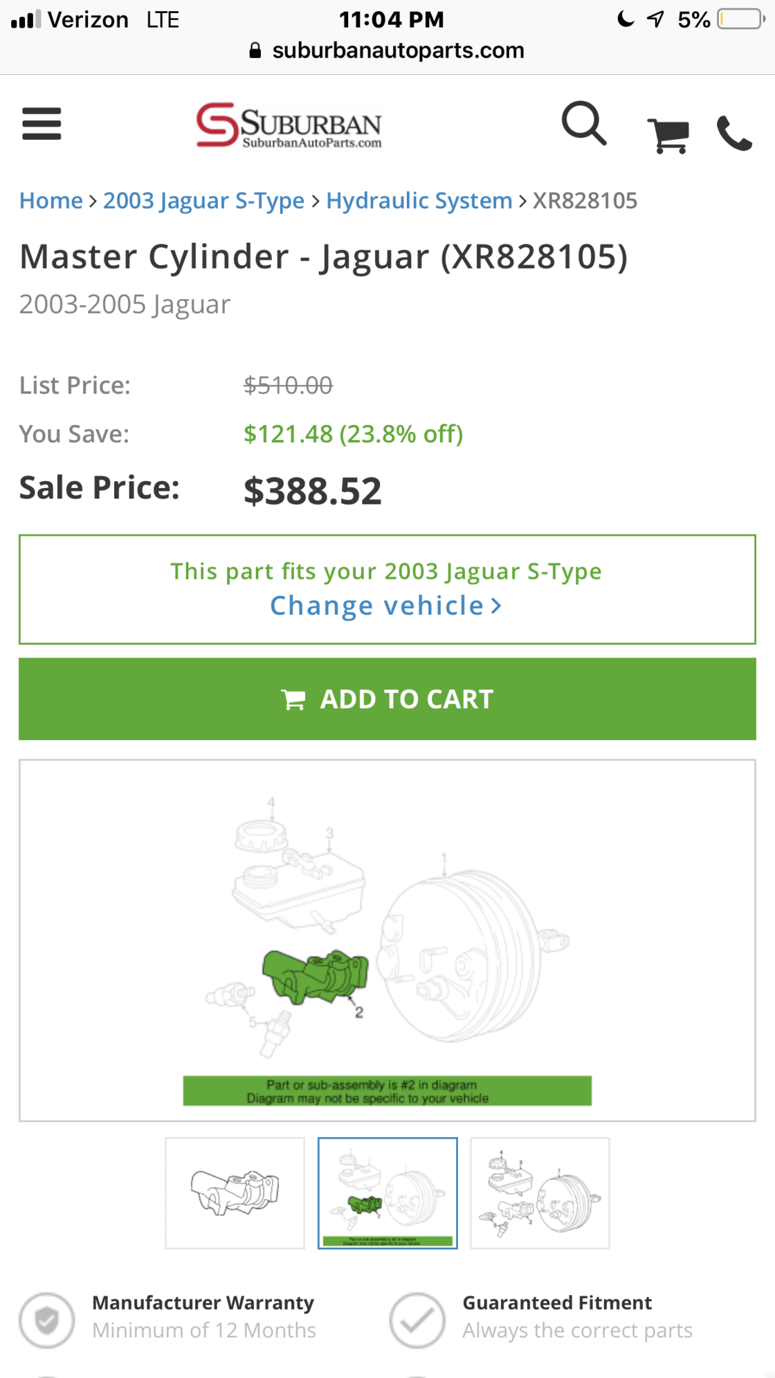

I am looking to order a master cylinder for my car. Part number seems to be XR828105, but I have been wrong before.
Funny thing is, when I look for the master cylinder, a lot of the sites are showing a part that doesn’t match the part on my car.
My mc looks like this:
And I find a part for sale that looks like this:
Then if I enter my vehicle info, and indicate s-type R, it comes back with the next part... same part number.
I’m feeling like I want the part that matches the one on the car. Was there an update to the MC at some point?
what are your thoughts?
and Thanks!

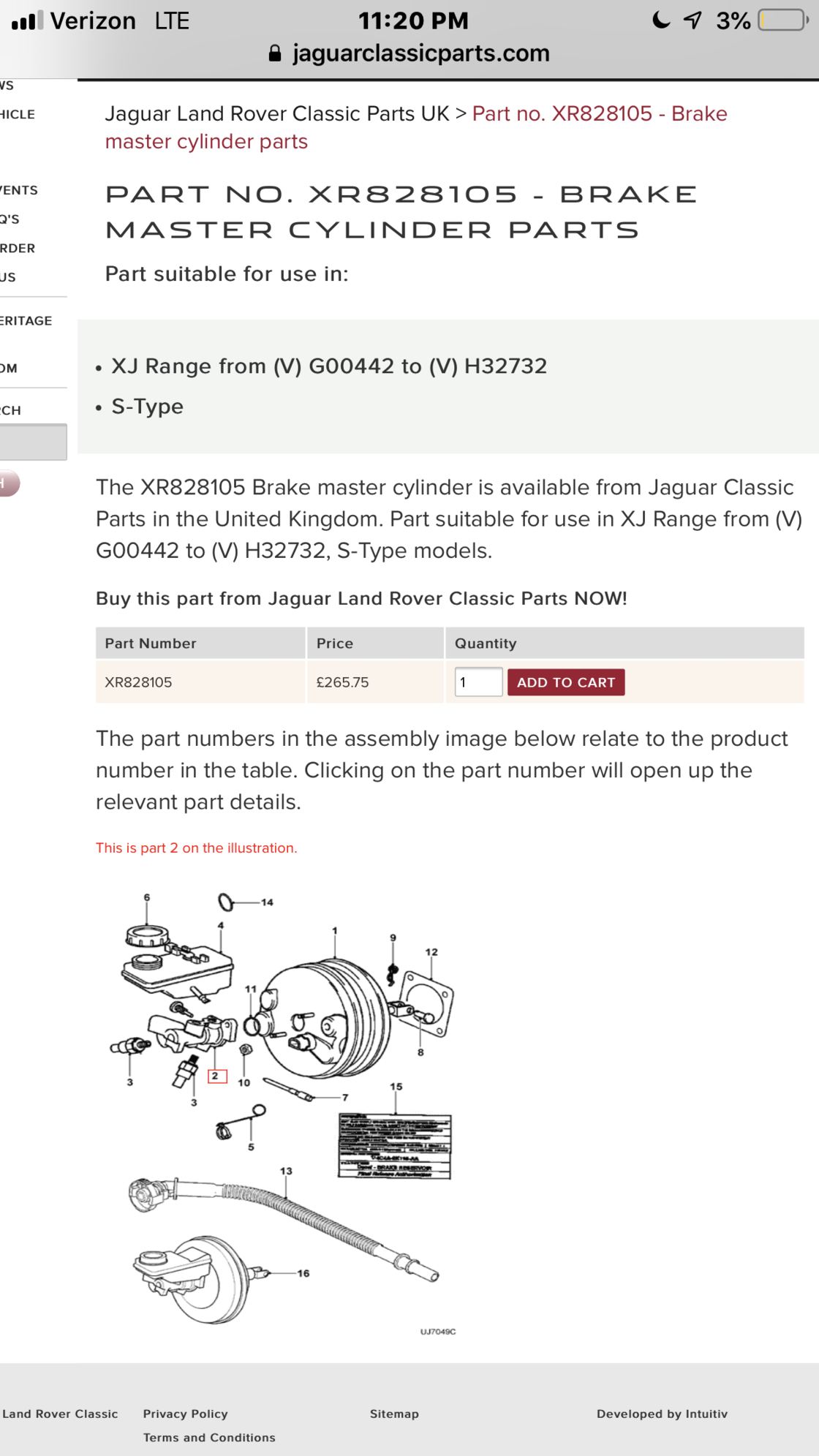

Here is another one. I don’t want to pay over $300 for the wrong part. 😳

The parts catalogue lists the following -
2. Brake Master Cylinder
LHD
To VIN M45254
Dynamic Stability Control XR826246
Except Dynamic Stability Control XR810526
VIN M45255 to VIN N52047
XR828105
From VIN N52048
C2C35765
RHD
To VIN M45254
Dynamic Stability Control XR826247
Except Dynamic Stability Control XR810527
XR829712
From VIN N52048
C2C35766
Hope that helps, all you need is your VIN number!

You can look up the part number yourself on-line on the official Jaguar parts catalogue:
https://www.jaguarclassicparts.com/uk/s-type-parts
As previously mentioned there are changes on VIN numbers and if you have DSC or not.
