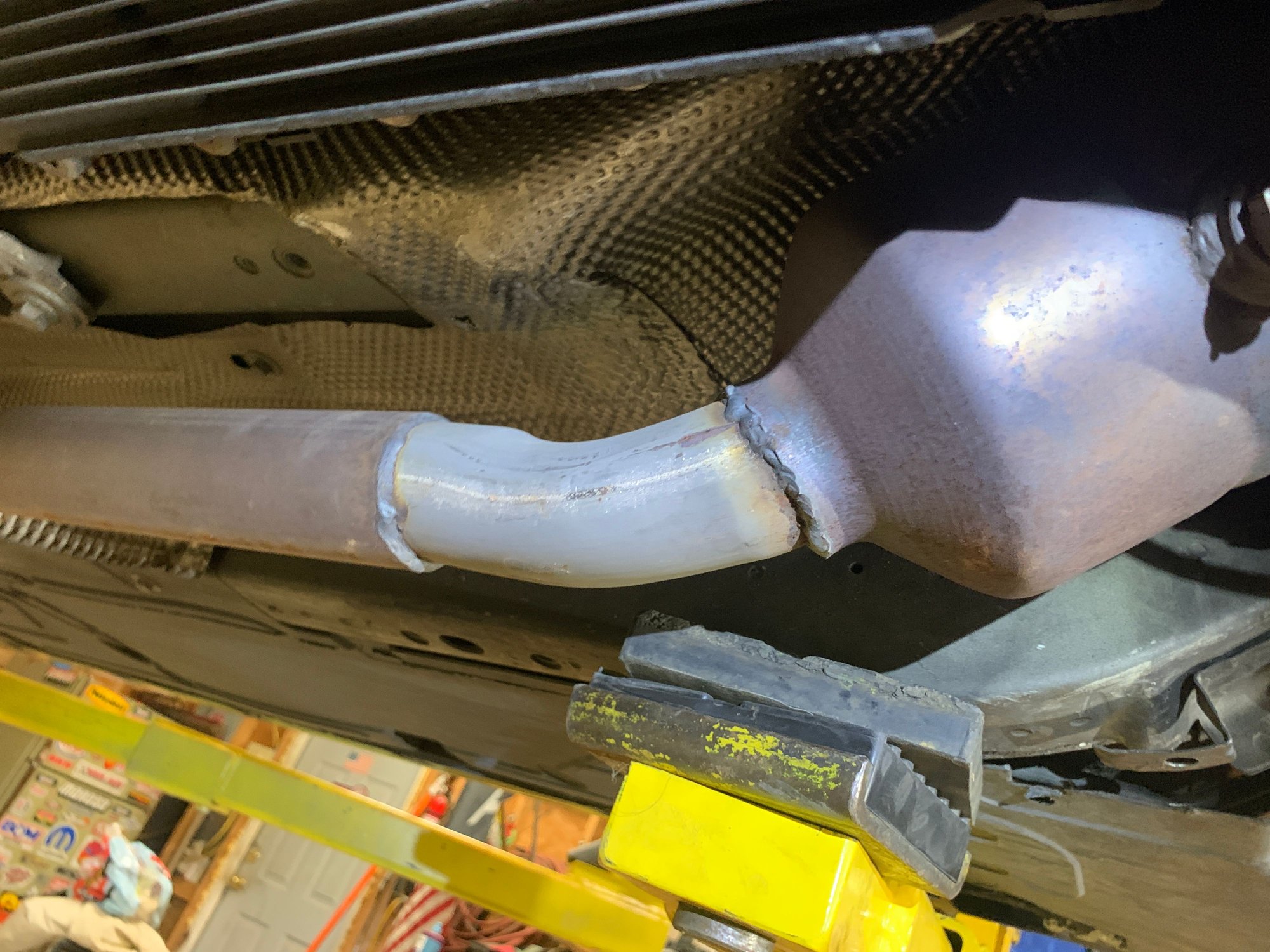

Look

Wow... that is some pretty poor welding! There is a gap where the spliced in section joins the exhaust pipe on the downstream side of the converter.
What a bodge job that is! Given the mis-match is diameters and sloppy welding, a re-do certainly seems a reasonable approach. You might want to contact "frankc" over on the British Jaguar forum and see what brand of 40 cell cats he had installed on his XK-R.

Totally boogered. Im not a great welder but I can do better than that! I decided upon this: MagnaFlow 59975 Universal Catalytic Converter (Non CARB Compliant)
Amazon Amazon
want to get new o2 sensors too. Im getting lean codes and hear the exhaust ticking so im pretty sure theres a leak

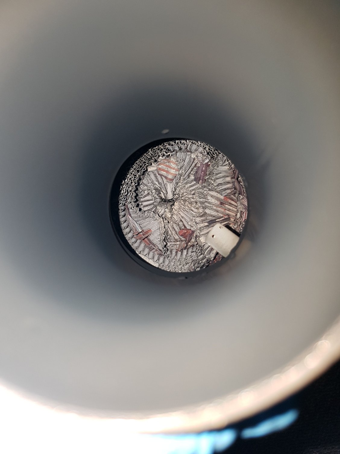

This was 200cel magnaflow in less than 7500 miles
I have to agree the welding and especially the mismatch in diameter is horrible. Might actually be loosing power with that bottle neck

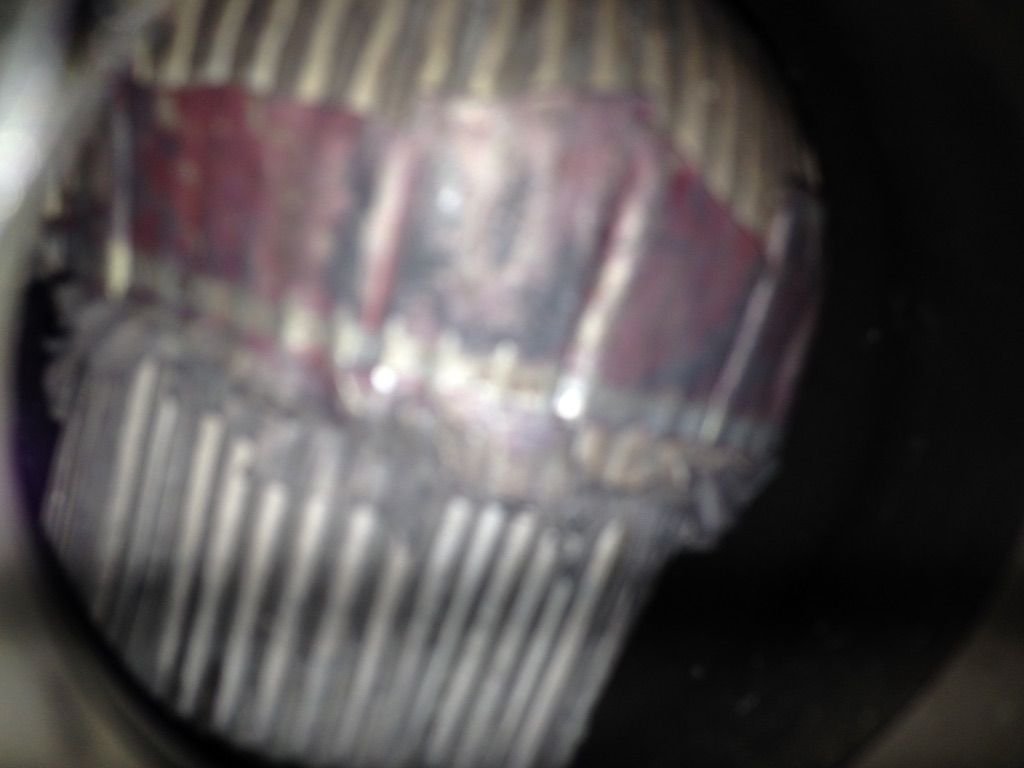

Yep this was mine after only 10000km
What brand did you have?

magnaflow 200 cell 59975 .

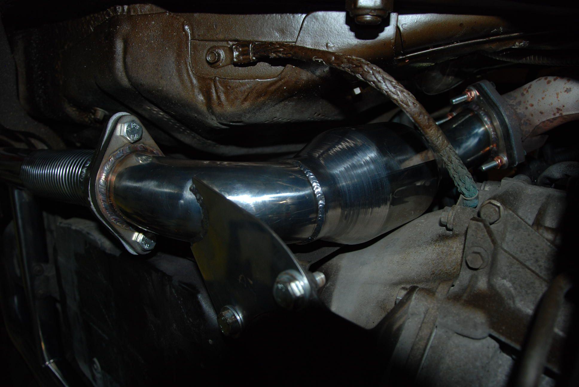

All aftermarket are small like that. What brand did you buy? Here is what my look like. I did test the flow and they do outflow stock by a big margin, but the issue is quality and they didn't last, even though my Afr ratio was set perfect and much better than stock was.

Old Sep 23, 2019 | 07:40 AM

Im confused why they pics of the failed units look like something collapsed the interior parts..... it looks like something mushed the plates over. These cats have a 3 year warranty I believe. For the ones that failed, Did you try to get them warrantied?
