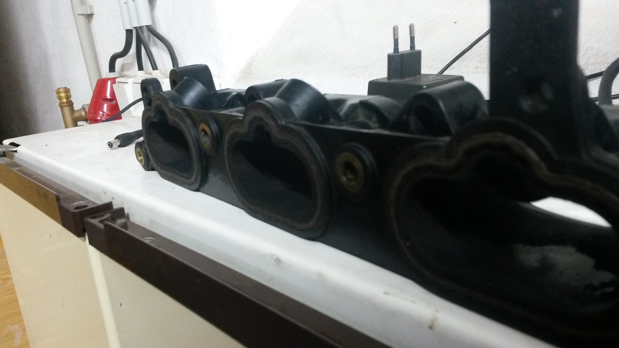

problem was found - the lower gasket under plastic with injectors
Very big air leak ...
