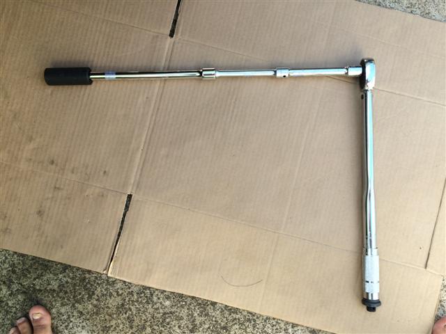

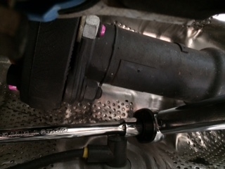

OK, to remove the lower O2 sensor from either side...
1 - remove the Throttle Body air intake Housing
2 - locate the 4 O2 Sensor plugs behind the Throttle Body, 2 grey and 2 black. The black ones go to the lower O2 sensors. Pull straight up on the plug assembly and it will come off the mounting stud.
3 - I tied a length of yellow masons string on each end of the plug for two reasons, 1 - so I would not loose them in the tangle of wiring and 2 - so I could use the string to pull the new plug up from the bottom.
4 - disconnect the plug assembly, get under the car and pull the O2 wire down.
5 - Cut the wire at the O2 Sensor. I used a long serrated knife as there was no room to get a pair of wire cutters to the sensor.
6 - I used 1/2" drive tools, using a 22MM or 7/8 deep socket with 1 ten inch and 2 six inch extensions, total extension length 22 inches, you can get a ratchet, I used my Torque wrench, onto the extensions rear of the transmission where the drive shaft attaches. Removal O2 downstream sensors - How-lower-o2-sensor-wrench-setup-small-.jpgRemoval O2 downstream sensors - How-lower-o2-sensor-installation-wrench-setup-car-3.jpg
7- remove the sensor.
8 - Using the same extensions but with an O2 socket I taped the O2 sensor and the wire along the extension using household Scotch tape. This makes it easier to re-attach the sensor and the tape breaks off easily when finished. The torgue for the O2 sensor is 32 ft. lbs. Removal O2 downstream sensors - How-lower-o2-sensor-installation-wrench-setup-car-small-.jpgRemoval O2 downstream sensors - How-lower-o2-sensor-installation-wrench-setup-small-.jpg
