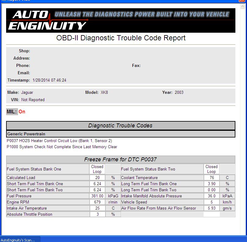

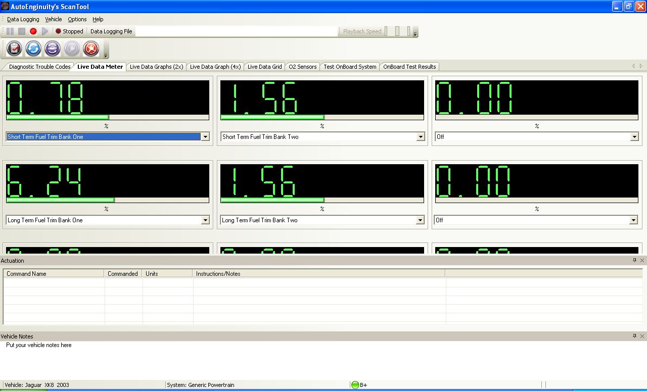

Kim reported a new engine light on today, so I went out for a look.
I guess the above figures were during warm up first thing this morning so had a look at the trims when warm this evening.

I just had a look and tested the sensor, its heater is open circuit. It looks pretty much impossible to access from the top, I'll get one ordered and try to fit it from beneath at the weekend.

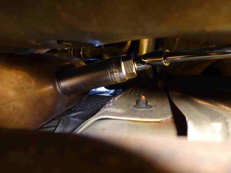

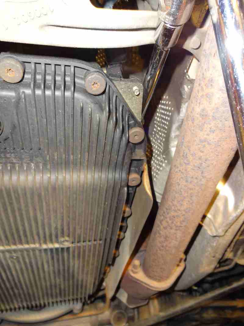

I bought this sensor from ebay and set about this job this morning, it took about an hour all in.
4-wire Post-cat / Downstream / Rear Oxygen Lambda Sensor for some Jaguar models | eBay
Access to the lower sensor from below is very restricted, the gap between the transmission and exhaust is only about an inch and a half.
This picture gives the wrong impression of how bad the access is.
Access was done this way with a wobble on the O2 socket and a couple of extensions.
I first tried it with a 3/8th set up which ended in failure.
So I moved on to 1/2 inch which was able to break it free.
I was able to reach down from the top with my skinny arms to screw the new one back in then tighten from below.
Job done.
