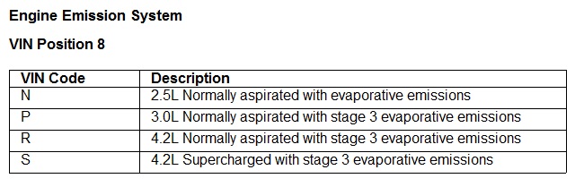

Please I really need help. My jaguar s-type car vin SAJAA01P53FM67589. how to find the volume of the engine 3.0 liter or 2.5?

Hayk,
Your VIN isn't recognised by the OnLine VIN Decoders but the engine type is shown by the eighth character - the letter 'P' :
As you can see from this table, letter 'P' is the code for a 3.0 litre.
