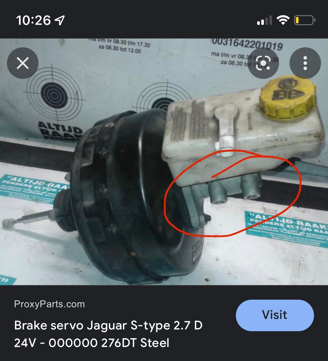

Hi
im upgrading my brakes on my 2003 (prefacelift) and i have a few diesel models selling for parts near me.
i have noticed that the diesel (facelift) has thicker lines from the master cylinder to the ABS Module (screenshots);
Also, the pumps are different(photos);
Would importing these to
my car increase the debit of fluid/presure?
Also #2, are the boosters different hence the diesel has a vaccum pump?
thank you!
Two green main lines on the right of the ABS module
Two black THICKER lines on the right of the ABS module
Diesel has different design

So, thanks to Joe on the facebook group we figured out its the brake pressure sensor and they moved it on the new abs module.
So unless you change almost all the brake system, it wont fit
