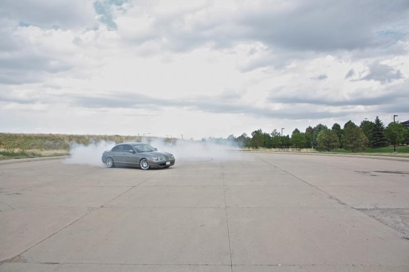

I should have searched the forum before I did them, because apparently I'm at least the 3rd member to have the same outcome. Anyways, now I need a power steering pump, as spinning donuts is like pressing a magic button that grenades them.

Fluid started gushing out of the front seal right after. There's a thread from about 4 years ago where 2 other members said it had happened to them. Anyways, I have a pump on order so the car should be back on the road Wednesday as long as I have the time to do the work. At least I got some good pictures !

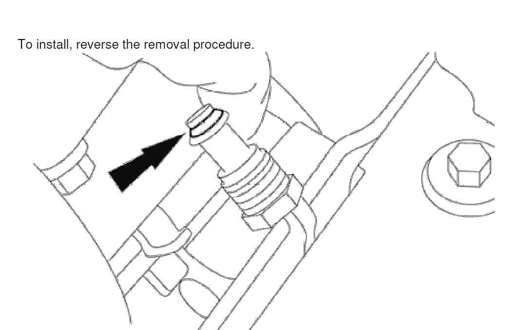

There is a Teflon ring on the pressure hose connection that I always change on other pumps and I will change it on the STR also. We are lucky to share parts with the Lincoln LS here because I found an aftermarket Teflon ring. Help #82540 has two different sizes that covers most Ford applications.
Here is the JTIS picture and they recommend changing this every-time the connection is broken. I have found the Teflon is usually shredded after taking the connection apart anyway.
