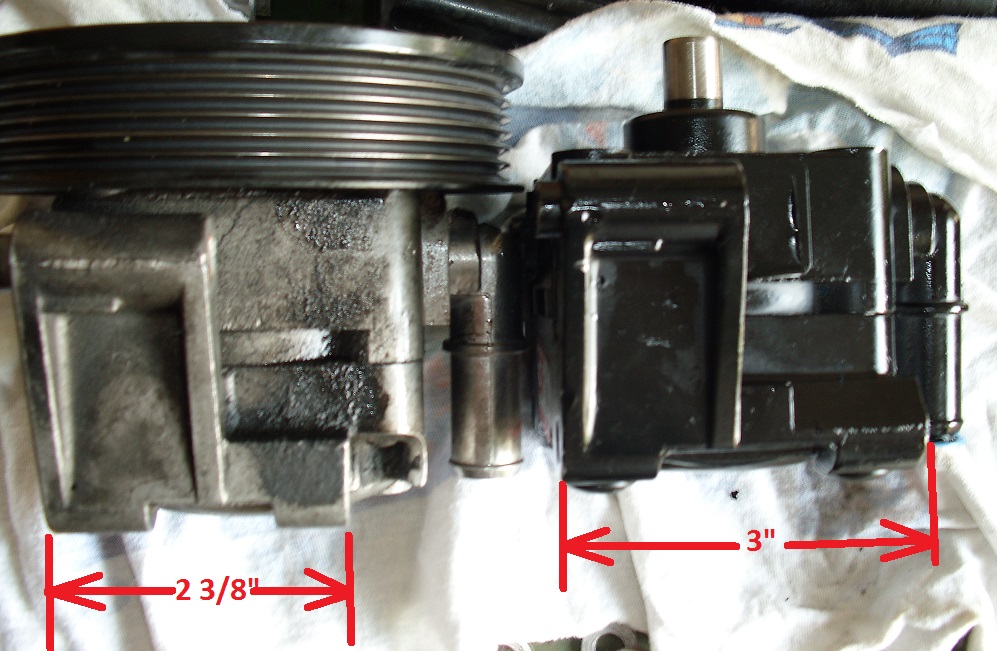

After all that the Auto Zone pump was wrong. See below as the mounting flange was too thick for the long bolts. Waiting to see if I can get the right pump.
Here is what's wrong. Stock STR pump on the left:
Well here is the next chapter!
With the wrong Duralast pump #5841 I returned it to AutoZone and they did not have a clue except to order another pump which of course would not get here until next week sometime! This was $240!
Since I know a lot of Lincoln LS stuff is the same I called around and got a V-8 LS pump from Oreilly's. A1-Cardone #21-5353 which was unbelievably cheap at $60!!
Identical pump! Both are ZF brand pumps with exactly the same numbers cast into the pump body. All the mounting points are exactly the same. The output shaft was the same length too. Even came with a pulley and the pulley had the same Ford part number on it of 2W93-3D673-CA!!
