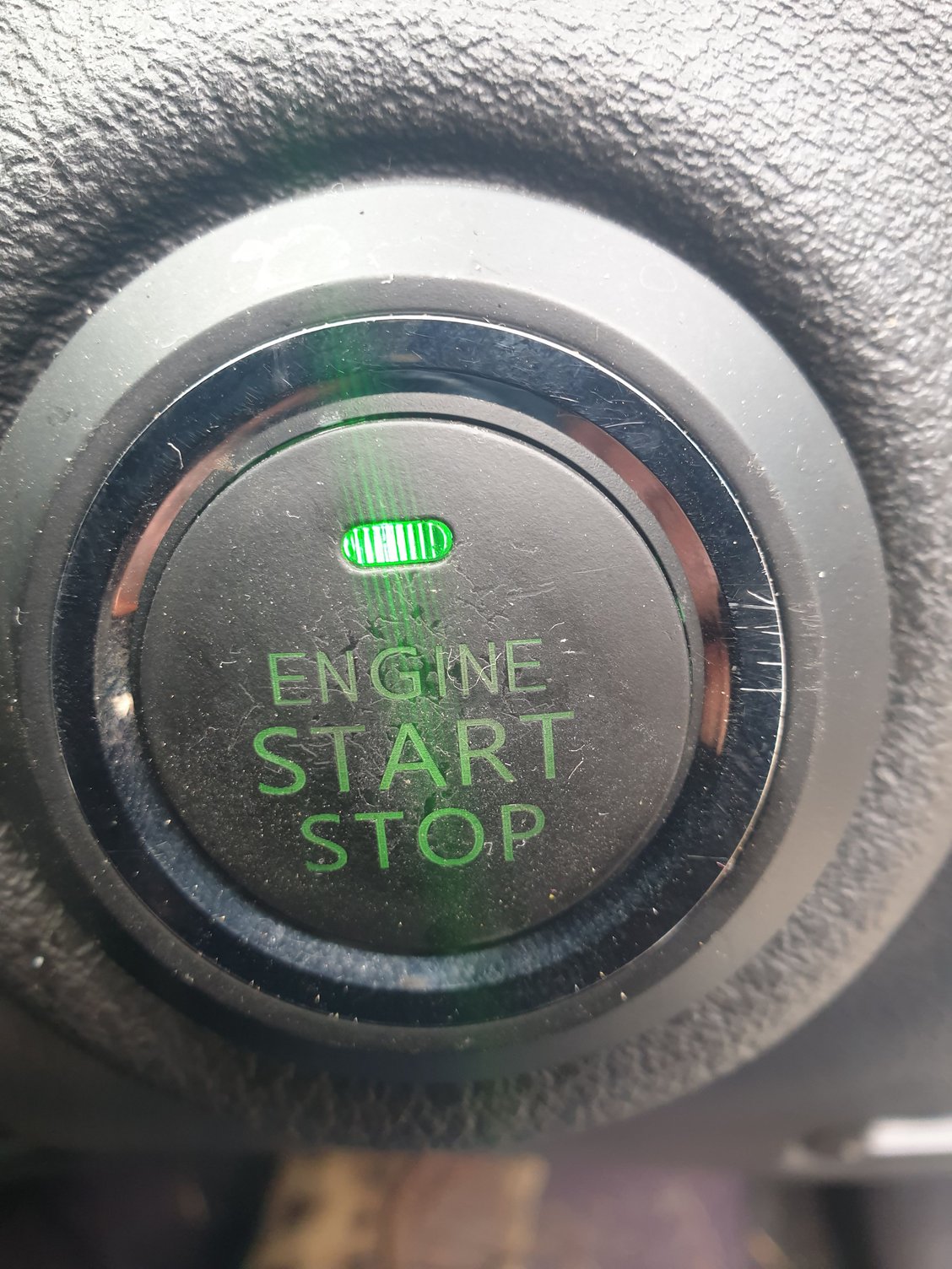

Hello everyone
I have had a couple of fourm members say I should do a post on how I did remote push button start in my 2004 s type
I am keen to do this incase someone else was interested in doing this
But unfortunately I am 99 % completele
but having difficulty with the alarm door trigger
Which means at the moment i am not using the automatic door unlock when i approache my vehicle
have to use the original remote
As if use automatic remote the alarm starts beeping and if passenger opens a door alarm gos off
auto lock is fine
so vehicle locks automatically when I walk away
my question
Dose anyone know where the alarm door trigger is or what wire

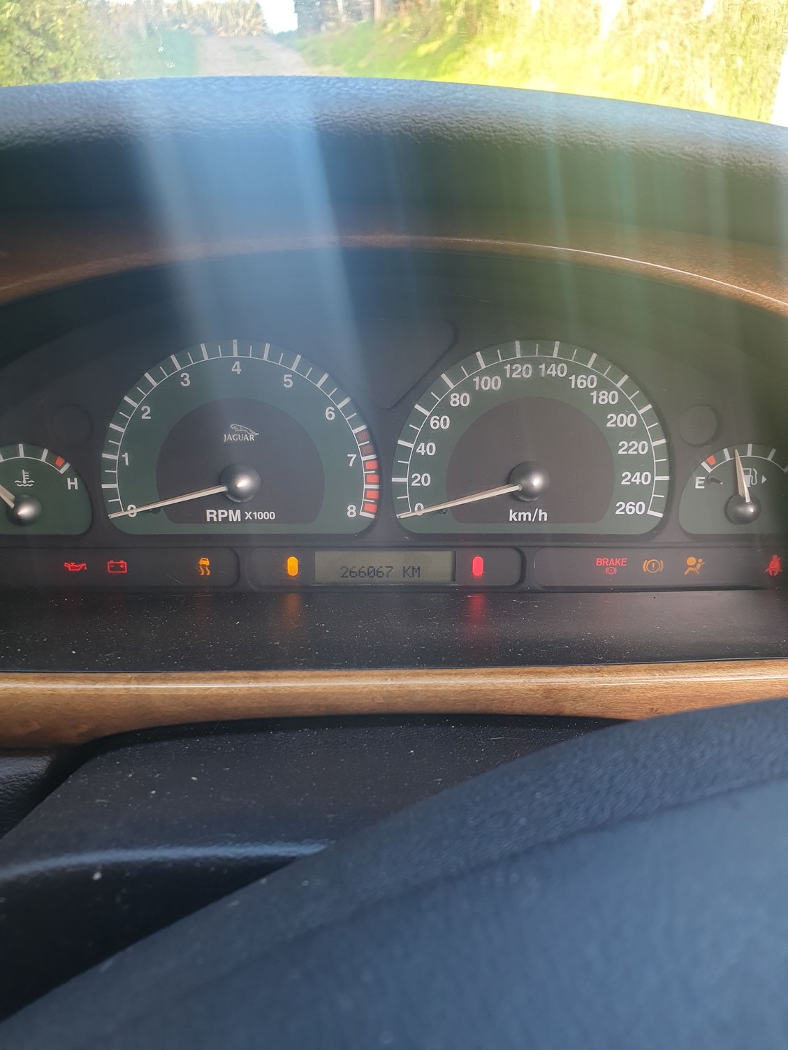

Blue light acc1 = radio & windows
Blue light acc 2 complete instrument cluster
green light engine running
Once I have figured out alarm door trigger
I would like to list with photos of how it is done
If anyone was interested
If anyone knows how the alarm door trigger works which wires
please let me know
Would be greatly appreciated
Thanking you
Darrol

bootleg pats bypass box or are you just taping a chip to the transceiver ring?

transmitter chip is in New remote which then sends a signal to transponder ring
