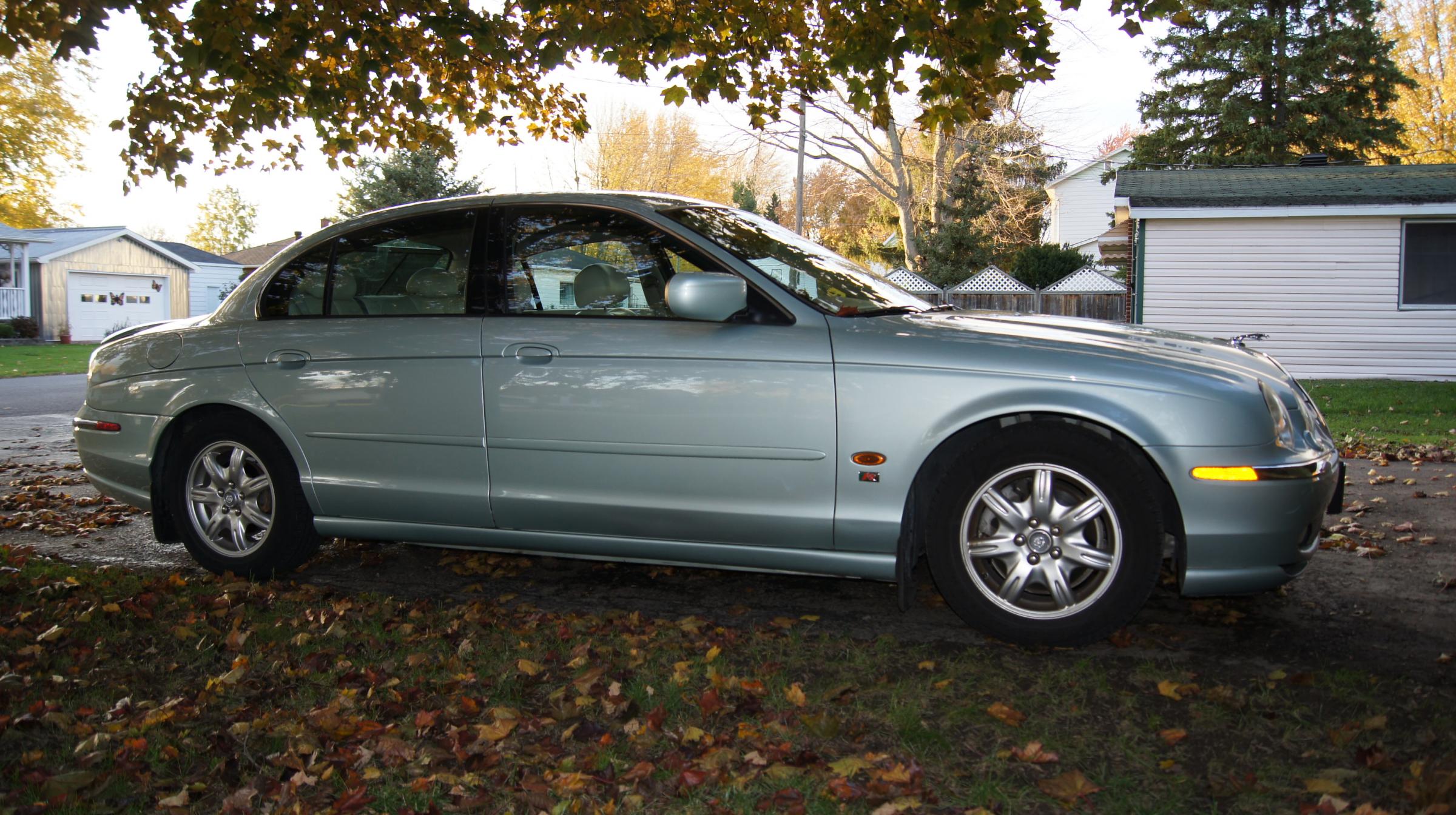

I have just purchased this car, and someone told me that it is supercharged because it has an R emblem on the side as you can see in my pic, but someone else told me that they never had supercharged until 2003. mine is 2001. Also I took to Jag dealer and he said that there is only 2 in North America like this. I am not sure who to believe or what so I am looking for some answers on here. I don't know to much about Jaguars.

2003 is first model year for S Type R.Check your VIN,eighth digit of VIN indicates engine emission system and would be "R" and tenth digit is model year and would be 3 or higher
Open the hood and look at the engine----the supercharger and the charge coolers sit right on top of the engine.
Just looking at your picture the wheels and brakes are not what was fitted to the SType R

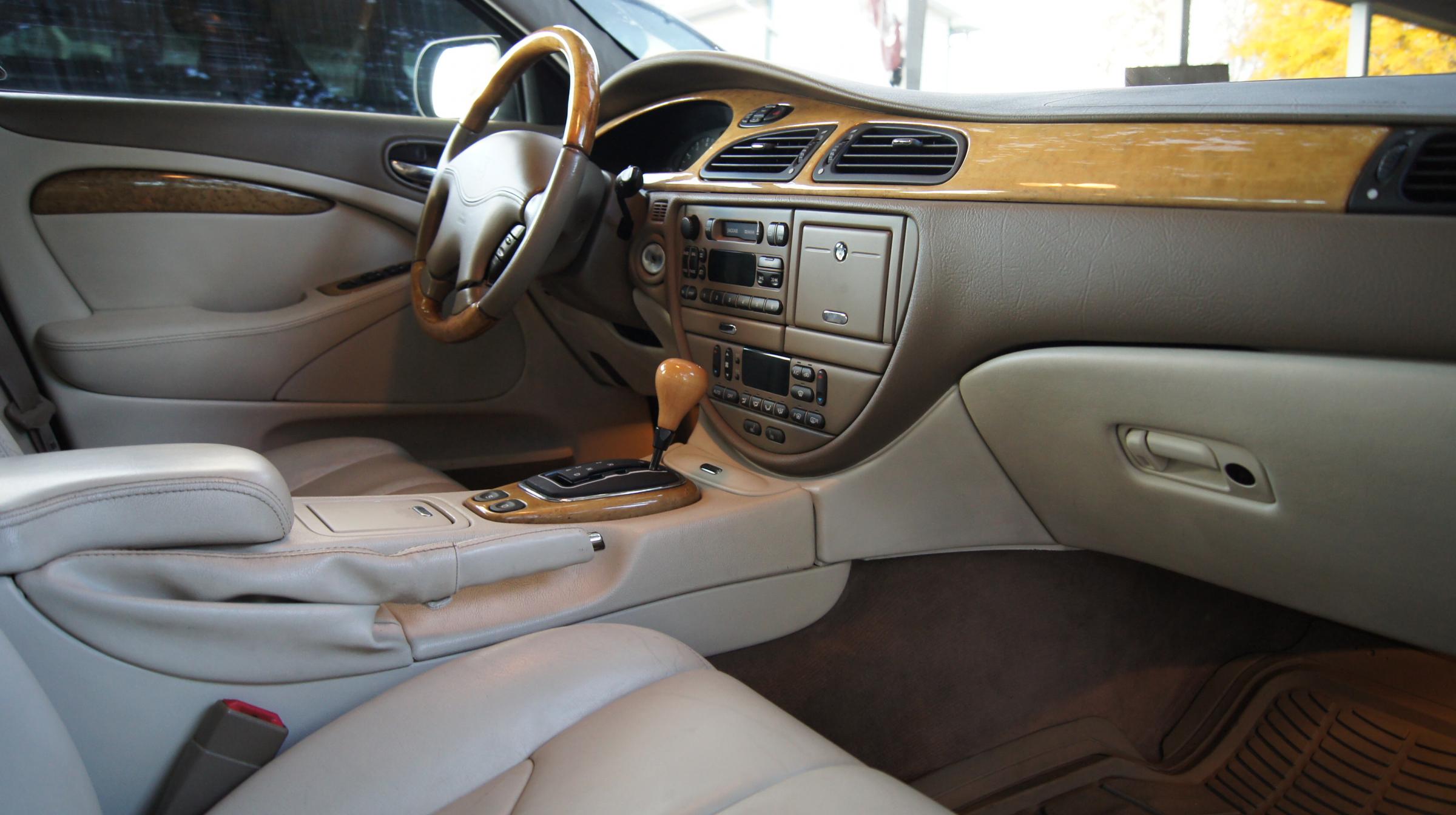

I checked it out and was surprised to find out that the normal 2001 S-Type wasn't produced until 2002.5 (a mid-year change) as a supercharged R model. That said it's possible that you have fallen into a late 2001 car that was actually spec'd out with the coming powertrain.
Easy to tell, just check under the hood and sitting in the center of the engine right on top is a Supercharger with two large air ducts labeled with the word 'Supercharger' on top of each one.
More likely that a previous owner dressed it up a bit....but look at the attached picture and then look at yours.

As others have said, most likely somebody put R badges on your non-R car. Take a picture of the engine and post it here.

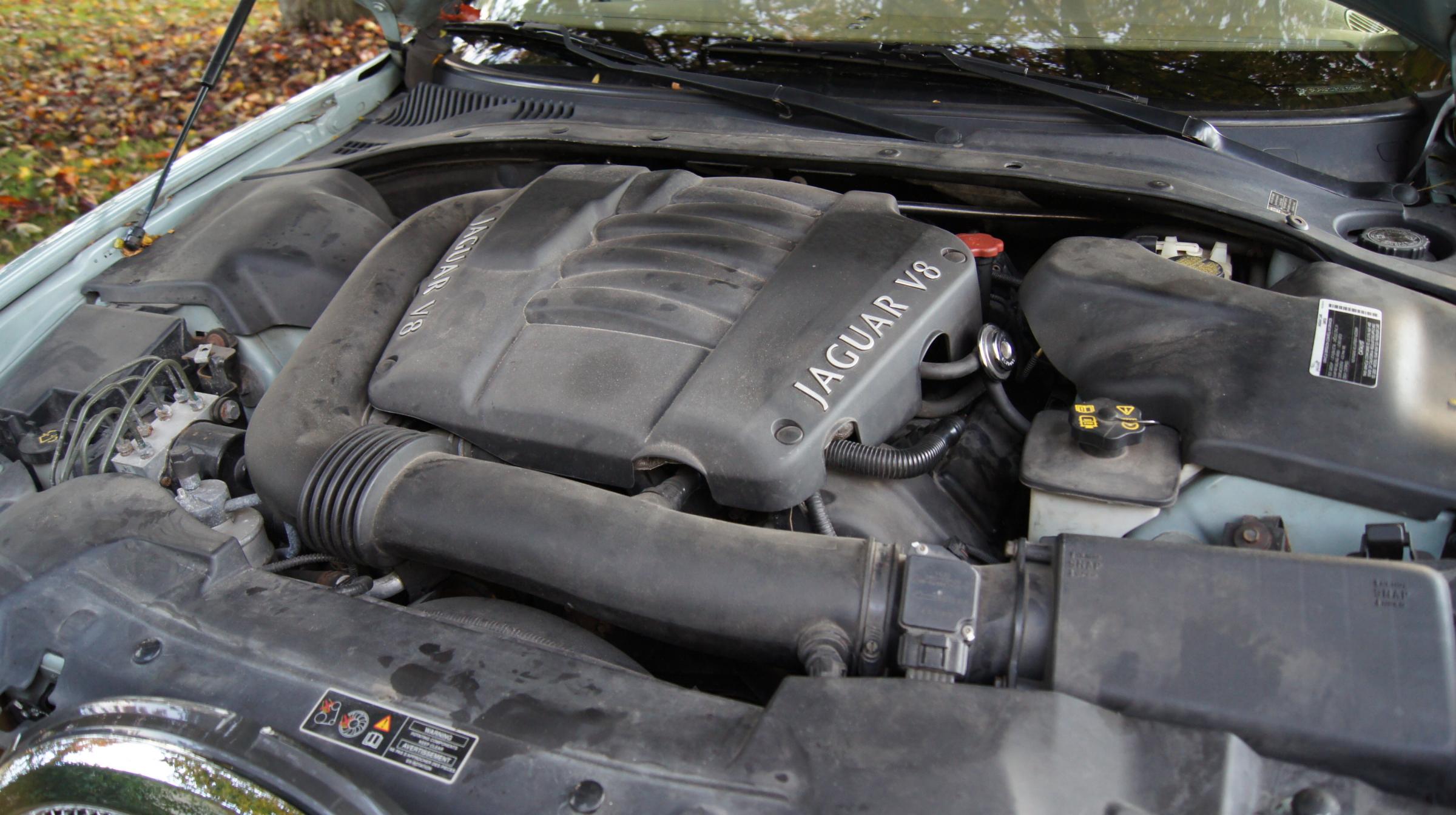

Here is engine, I do not believe it is supercharged but you tell me.

Nope, standard 4.0L V8. Sharp looking car! Congrats.

Yes somebody just added the "R" emblems. Do you have the third one on the trunk lid?
