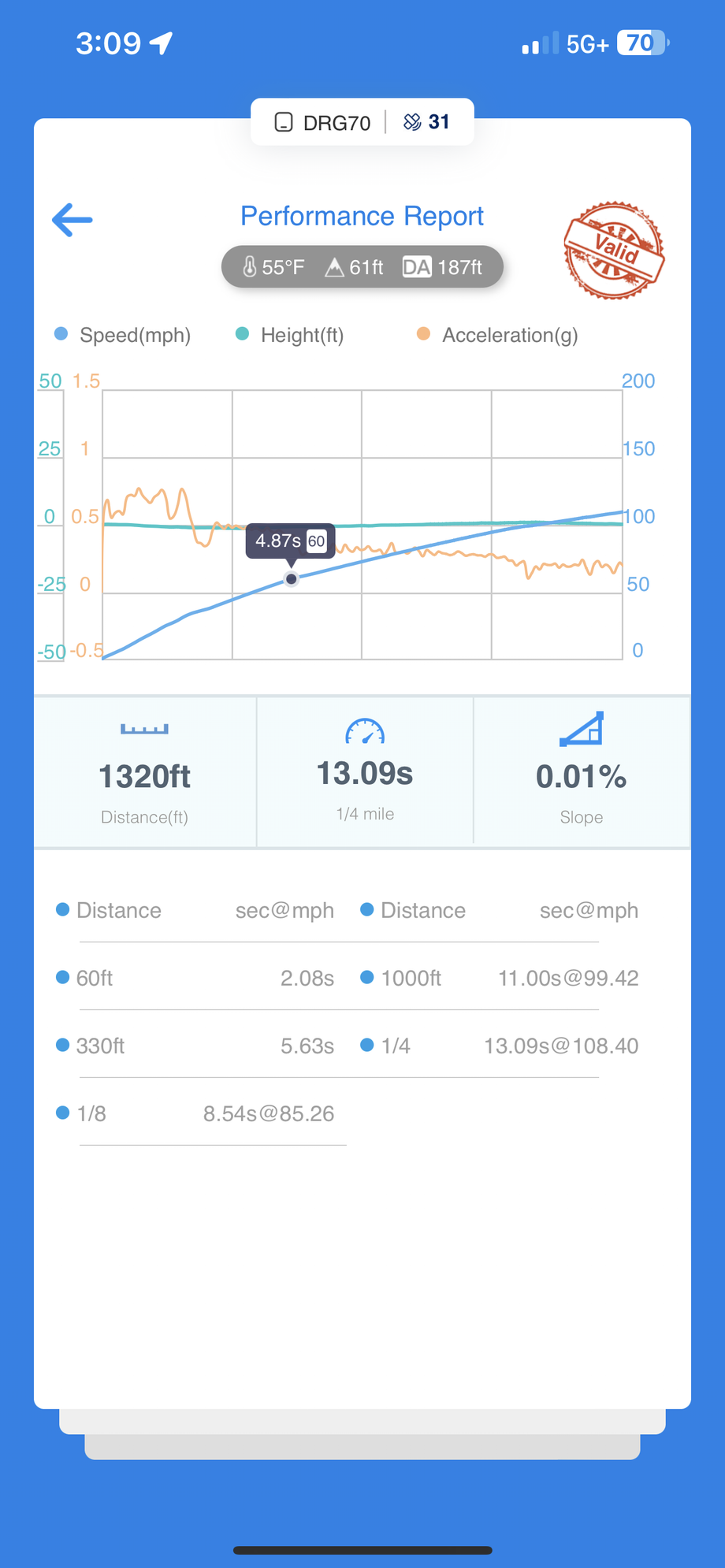

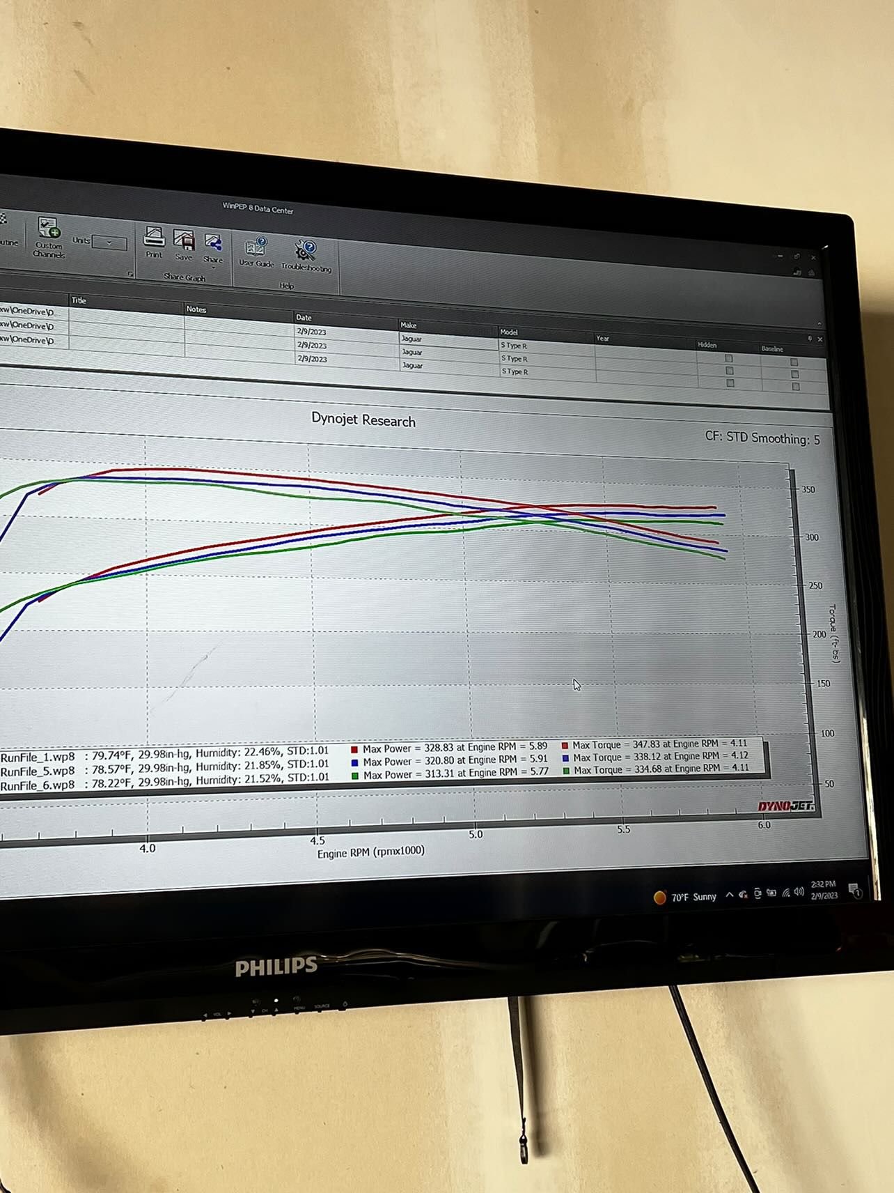

So I recently have gone through the trouble of getting a dragy and my car has managed a 13.09 @108 with a 4.8 0-60 “see below”. Granted my car is a 06 and I’m tune only at this point, but I’ve had similar numbers at the track when completely stock. Car does very well and keeps up with a lot of things one wound think would be quicker. Certainly wouldn’t be so quick to give the car the boot, might do a new set of spark plugs, I ended up getting NGK Ruthenium’s, and also a good set of tires. I have Toyo R888R’s on the rear and they’re as sticky as a pack of gum. I’m constantly tinkering with my car so if you’d like to follow the progression I’ve linked my YouTube down below. My instagram is the same as the YouTube.
https://youtube.com/@onefastboi14
Completely stock power figures

Holy ****, see, that's why I started wondering. 4.87 on a 0-60 run, that's almost 2 seconds faster than mine. Something must be off.
Thanks for that dyno data too. I'm taking mine to the dyno asap. Looks like the "standard" 18-20% drivetrain loss can be expected.

Certainly seem’s like something would be off. I’d be happy to update my Dyno numbers today after said tune. Taking the car to the original Dyno I went to, to have them check out the power figures as of yet. If you’re nearly 2 seconds off my 0-60mph figure I’d be interested to see where you are in terms of 1/8th mile and 1/4 mile figures. Something definitely sounds off.
