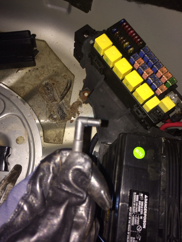

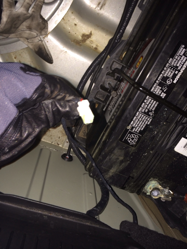

Was in my trunk and notice 2 different a
"Wires" just hanging out with no purpose. I'm sure their suppose to be somewhere but I couldn't figure out where . Hopefully you guys can help the pics are not the best but hope they can help.

Ooh, ooh, ooh! Mr. Kotter, Mr. Kotter, I know this one!
That connector is for the transit isolation relay. This relay was only used in transit from the factory to the dealer, at which point it was permanently removed. Details here:

Make sure it cannot short to anything.

The first ones not a wire is it?
It looks like the battery vent connection to me.

Norri- any suggests where it goes couldn't find where it goes just bothers me that their there just hanging out

see post 2. It could be that your current battery doesn't have a vent?

Sounds about right thanks guys.
