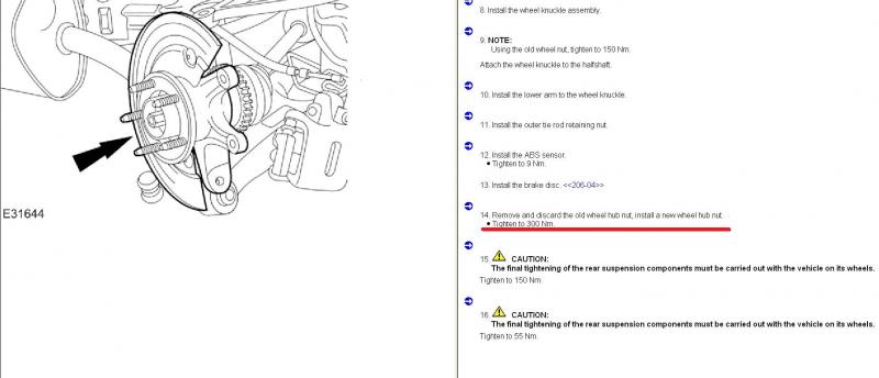

Thanks for the feedback. Just another example of how a simple repair gets blown up into a big deal because it's on a Jaguar!! Just a common wheel bearing repair and it does not cost that much to fix.
You were pretty close on the wheel hub nut torque. JTIS says 300 NM which is 221 Ft/lb. Maybe give it another lick??
Here is the JTIS instructions. I normally reuse the hub nut but just about all manufacturers will say replace it everytime.

Thanks Club, I will re-torque that nut this weekend as it should only take few minutes. Im not sure about the statement about "final tightening...with wheels on the ground." Many of the components (nut/bolts) cannot be reached with the wheels on and sitting on the ground? Anyway car is running/handling great but Ill see what can be re-tightened then if need be. Thanks again to all

Generally when you're supposed to torque that way you very definitely should do so. Put it on 4 bricks or something if need be but you need the weight on the wheels.

What it means is: with the wheel centre cap removed and the vehicle on a flat, level surface, a socket is inserted through the wheel and used with a torque spanner (wrench) to tighten the nut to the correct value. It is always a good idea to have either the brakes applied or the wheels otherwise prevented from moving so the correct tightness is achieved.
