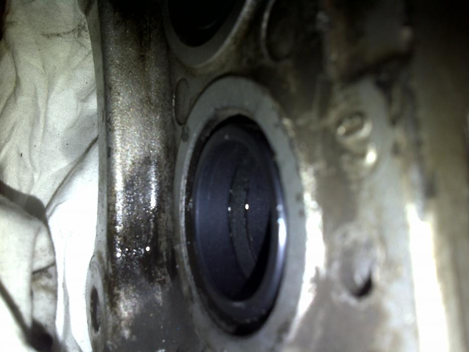

OK, bougth 28 and 30mm seal kits from Z_________racing.
Have them apart cleaning and preparing to re-assemble, however I need a 30mm replacement piston.
Took them apart with air, you could probably do this without air by removing the dust boots 1st and CAREFULLY prying the pistons out. but I had air, and put a pair of old pads inbetween the pistons and popped them out most of the way, and finished with hand tools to pry them out.
Once the dust boot is gone, they do wiggle out by hand ok.
Attached is a photo of one really bad piston.
The other photo is the pressure seal still in the caliper, which is twice as 'tall' as the ones supplied with the kit.
They are not nicked, so I am considering leaving them be.
Anybody suggest what to use to clean up and remove brake fluid when I am all done, have been sloshing it all over the parts and caliper, will want to clean up when I am done.

Simple Green has always worked well for me when I didn't want something corrosive. How many miles are on your car? That worries me being that nicked.

Default 80K miles
My car has 80k on it.
This is a north eastern car, so salt will contribute to things.
one other was VERY slightly nicked, but none of the others.
Pete

Judging by the corroded condition of your pistons the car spent time in a winter salted and humid environment. I'd also say that the fluid wasn't bleed frequently enough.
