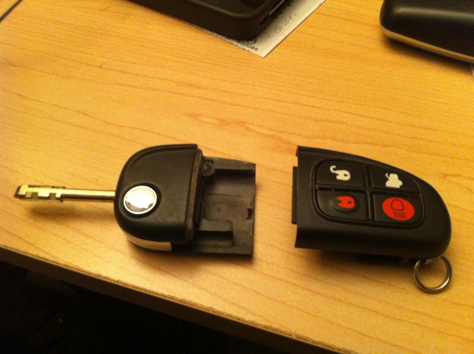

Ok time to clear up some confusion.
First. The remote switchblade key is two pieces, each sold separately.
The first part is the folding metal blade, the second part is the keyless entry remote.
BOTH have to be programmed to the car. The folding metal blade which has to be cut to the car has a transponder in it, which enables the car to start.
The keyless entry remote also programs to the car but they are universal, any remote can be programmed to any car. ALL keys must be present at the time of programming (up to 5), as the programming sequence deletes previously programmed keys.
NOW, if you're just looking for a doomsday crap I lost my keys key to hide in a safe place, you can get a "post" key. Which isn't a frequently discussed option.
Still has to be cut, and programmed to the car at the time of programming the rest of the keys, but costs alot less.
Oh and something interesting that most people might not know. You can stick any S or X type key into any S or X type, and it will lock the car, even if it wont unlock it because it's the wrong key. IF you have more than one, try it. (Ask me how I found out about that one LOL).
Take care,
George

George is correct, but we call that a black master key(non flip) its a cheaper spare than the flipper w/remote.
