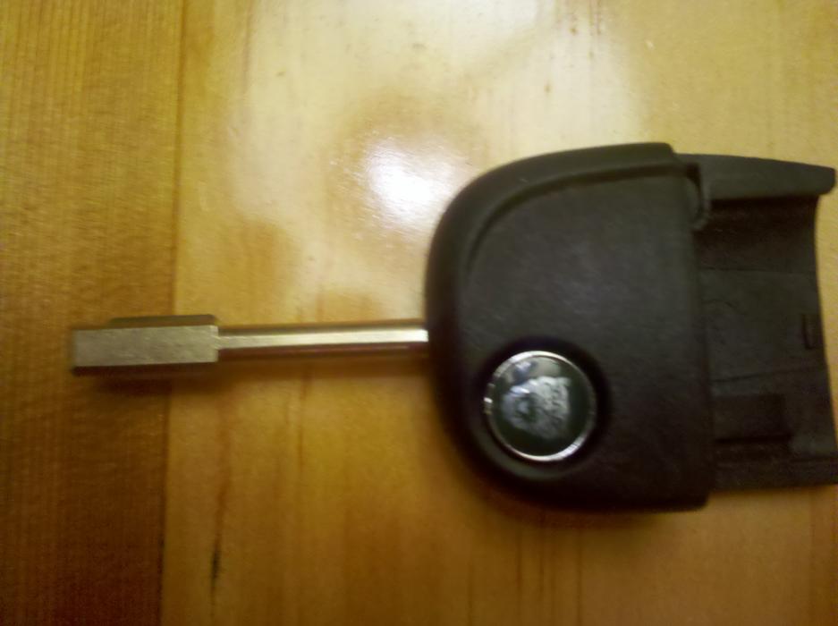

Here is the problem with my eBay key as explained to me by the dealer:
The blank he was selling already had the point on the end, pre-grinding.
You can see mine was squared-off.
btw...if you have only one key/car, yet >1 car, be careful. A little tidbit I picked up on the x300 forum was that Jag keys were fairly universal at locking Jags, but not unlocking. I don't think it is THAT bad, but within series it seems to work. My 03 Stype key will lock the 05, but not unlock it. However, x300 key won't lock the Stype. My guess is that you can lock most any S-type with an S-type key, so in theory, you could lock your only key in the ignition.
