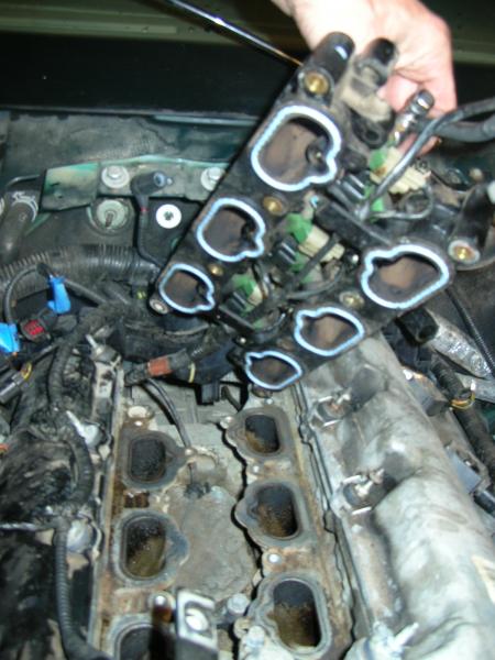

Isaiah, I am not really familiar with your MY 3.0. I went through all of my realtime photos I have taken over the years looking for that hose, sorry I came up empty. Have you downloaded JTIS, free here on the forum?
I am posting the picture below of a 2003 MY that I worked on many moons ago for a fellow member.
I have to ask have you "lifted" the lower intake manifold to expose the 6 odd shaped intake seals, and also it exposes the infamous rubber hose 90 degree elbow that most likely needs to be replaced. It is not shown below, they engineered it out for the 2003 and up MY's. The elbow and replacement is shown on Gus's site and referred to in my post #5 link above.
Attached Thumbnails Replaced alternator and jag still wont stay on-lower-intake.jpg
