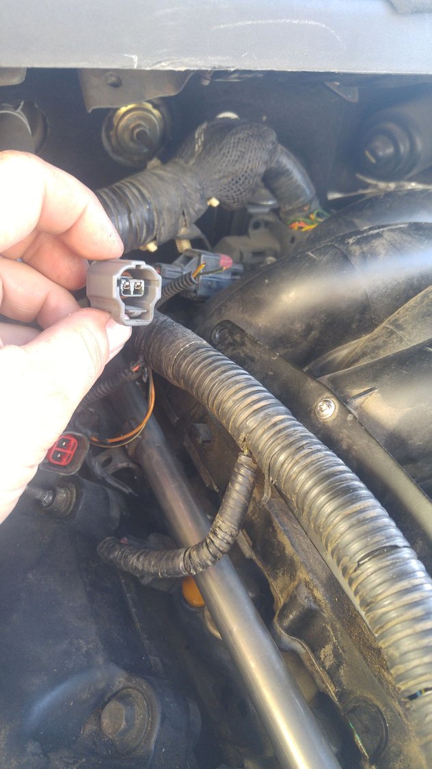

So I pulled the injectors out. Little buggers were in there pretty hard. Unfortunately, I missed a wired connector at the back of the passenger side injector rail. I pulled a little too hard and the 2 wires pulled right out of the connector.
Does anybody have a schematic to show where these wires go to? I am assuming they are a pressure sensor or some other type like that. Also helpful would be how to re-attach or splice or weld the wires back to the connection.

Broken EFT Sensor connector to Engine Control Module
I pulled the P127 connector off of the leads for the EFT sensor which runs on the right side fuel Rail toward the fire wall. I need to know if anyone know where I can purchase a new female P127 connector. I have been researching them for several hours now and it seems the P127 may be a Jaguar number. (it is noted on Figure 03.5 of the manual Gus posted. Thank you Gus for that BTW)

I got the ELM327 OBDII sensor up and the following codes come up.
Current Faults
p0182 - Powertrain - fuel temperature sensor A circuit low input (makes sense since the wire is severed)
P0191 - Powertrain - fuel rail pressure sensor circuit range/performance
Pending Fault
P1000 - Powertrain Engine Control Module DTC -Manufacturer Controlled - internal error, Cause - ECM

The P1000 is not a fault in the least. This code will be displayed every time the battery is disconnected and will remain until all systems have had an opportunity to self test and set the monitors. P1000 will then be replaced by P1111.
P0182 is probably the temp sensor with the broken wire.
P0191 is probably the actual fault- the pressure sensor.
Again, this points away from faulty injectors.

UPDATE:
Replaced all injectors - No leaks
Replaced the Fuel Temperature Sensor Plug - Working Normally now, cleared OBDII code P0182
Replaced the Fuel Pressure Sensor - Working Normally now, cleared OBDII code P0191
No codes currently showing other than the P1000 (I am assuming from disconnecting the battery).
The car is cranking normally, battery is showing 13.6V, Fuel is getting to the fuel rail as the pressure valve spits when depressed. I can smell fuel coming through the exhaust. However the car will not fire over. Not even a hiccup.
I checked the ignition coil relay R3 in the front power distribution box and the left and right plugs indicate 14.1.
Anything I am forgetting here that needs to be reset or checked to get ignition going? Battery was disconnected during service.
