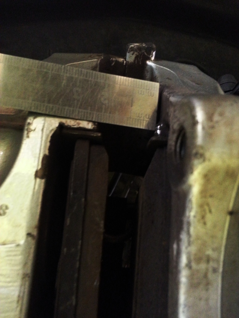

I just popped into the workshop & had a look
Yep the narrowest part of the caliper is only ~22mm, so yes a spacer would have to go in the middle of the caliper.
Reading back over this thread, I realise why I got confused, Joe is using a rear Brembo caliper from a 2011 Camaro (post #18)
Ummm....
Well the spacer on the e-brake caliper seems to work OK to accommodate a 28mm wide rotor, why not do the same with the main caliper, it's a split design, would just need longer bolts & new crossover tubes...?
Attached Thumbnails Researching S-type brakes/Suspension differences.-20131002_161809.jpg   Researching S-type brakes/Suspension differences.-20131002_161754.jpg
Old Oct 2, 2013 | 03:46 AM
  #49
JagV8's Avatar
Posts: 27,550
Likes: 4,928
From: Yorkshire, England
I think the XKR Brembo rears use 330x28mm (vented) discs. Not sure which years etc. 2003, I think.
I'm not sure what's "wrong" with 15mm solids on the rear, but that's another topic!
Old Oct 2, 2013 | 08:19 AM
  #50
Tijoe's Avatar
Posts: 1,558
Likes: 592
From: Kalispell, Montana
As some of you may know, I abandoned using S-type rear suspension and went with a combination of C6 Corvette and Camaro parts for my hub carrier, hubs, brakes and am building custom a-arms to mate the parts to the sub frame. (Posted in other threads.) Jag-V8 does have a good point on the STR. What is wrong with the solid 15mm rotor? Perhaps less heat dissipation than a vented rotor? Unless you are driving your STR on the track or heavy duty street work and you are crazing and cracking the surfaces of the rotors, then solid will stop as good as vented.
Before trying to go to 28mm wide rotors, You should calculate where you would want the added thickness, in-board, outboard, equal spacing front-back from the existing centerline. I don't think there is much clearance between the outside of the rear Brembo and the wheel. If you stick all 13mm (1/2") outboard, I bet the caliper will hit the wheel.
If it hit, you will have to back space the calipers until they clear.
Joe
