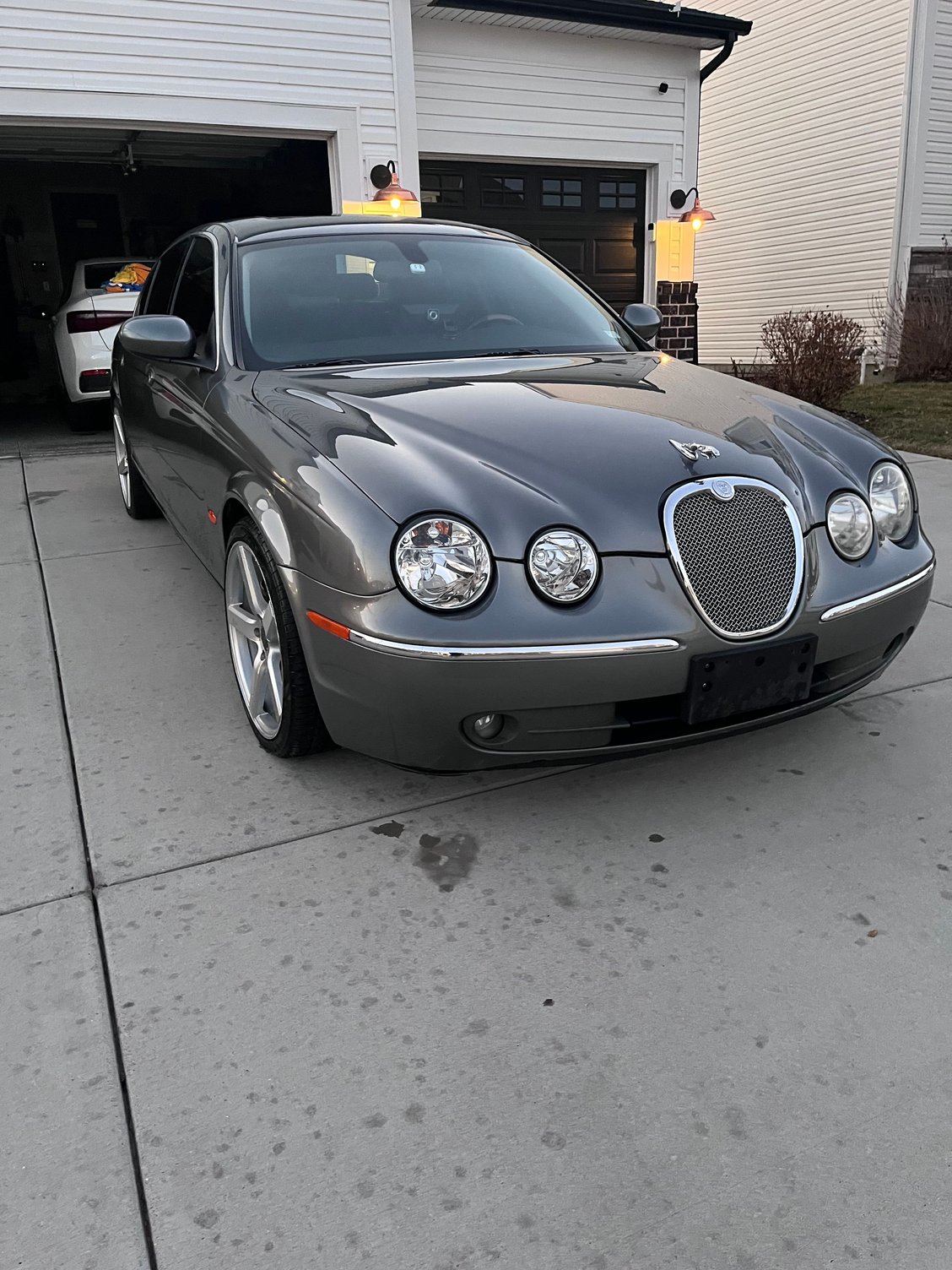

Oh I forgot to mention that is one VERY clean looking S-Type! Nice!
