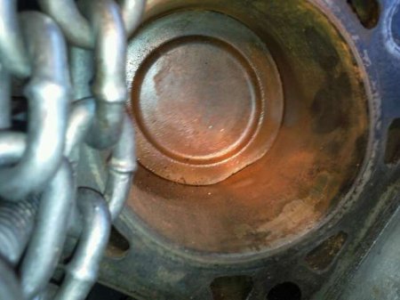

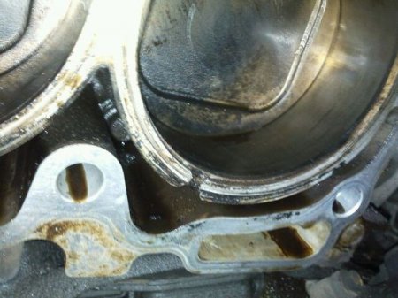

I found this to be a very good explanation:
What You Need To Know About Overheating A Vehicle | Shade Tree Speed Shop - Automotive Repair and Performance in Denver Colorado
I am a little calmer now that I understand a bit more.
The odd thing is - my car had none of these symptoms apparent when running. It was serviced a few weeks back and was checked with the correct software two weeks ago for faults - and none appeared. So, it would seem that two weeks ago, it was running fine.
Dammit.
The first thing you must know in regards to a vehicle over heating is that most modern cars use dummy gauges. A dummy gauge is a type of gauge that only generally reflects the actual data. For example, the coolant temperature gauge will show cold, normal and hot, but will not show the many temperature fluctuations an engine goes through while driving. The problem with this type of gauge is that by the time the temperature gauge shows a hot reading, the engine has already reached a very high temperature, and has in many cases caused major damage to the engine.
Next you must understand the anatomy of a modern engine. Modern engines consist of a cylinder block, and one or two cylinder heads, depending on whether the motor is an in-line motor or a V’ed motor. Generally, an inline four-cylinder engine looks like this:
The cylinder head sits on top of the engine block and a cylinder head gasket seals the space between them.
Furthermore, most modern engines use an aluminum cylinder head and a cast iron engine block. Some engines, such as Subaru, use aluminum cylinder head and an aluminum engine block. The aluminum cylinder head is in many ways more efficient than the old style cast iron cylinder head.
The main draw back of an aluminum cylinder head is that when the cylinder heads becomes too hot, they easily warp. A cast iron cylinder head can be warped, but it must reach a much hotter temperature, and must reach that temperature many more times.
The warped head no longer has a proper mating surface in order to maintain a tight seal between itself and the engine block. Because the tight seal is lost, the cylinder head gasket eventually goes bad. The bad cylinder head gasket causes the vehicle to continue to overheat.
You see, the anatomy of a cylinder head gasket is such that there are many holes in it. Some holes are for the pistons to pass through, some for oil to pass through, and some for coolant to pass through. When the cylinder head gasket goes bad, it allows some of the exhaust gas to go from the cylinder area into the coolant. The exhaust gas is much hotter than the coolant, and also forces air into the cooling system. The combined effect of the hot gas and the resulting air pocket in the cooling system results in a vehicle that overheats, despite the otherwise proper cooling system.
Symptoms of a bad head gasket and or a warped cylinder head include:
Overheating while under load, cruising down the highway, or in stop and go traffic despite and otherwise working cooling system.
Rough idle at first start up after sitting for an extended period of time. While the vehicle is not running, coolant may drip into the combustion chamber and cause a misfire until that coolant is burned off.
White smoke out the tail pipe at first start up. Again, the coolant may drip into the combustion chamber while the vehicle is off, the burning of that coolant results in smoke.
Vehicle continually needing coolant added despite no visible leaks. The engine consumes the coolant and burns it; therefore it constantly needs to be topped off.
Excessive pressure in the cooling system while the engine is running. The same combustion force that drives the engine pushes the exhaust gas into the cooling system, resulting in very high pressure in the cooling system.
Continual boiling over and pushing fluid out the overflow reservoir. Because the exhaust gas is forced into the coolant, the pressure becomes so high that it forces the radiator cap to open and pushes excessive amounts of coolant into the overflow reservoir.
Hydrocarbons (a component of exhaust gas) in the cooling system.
Oil in the coolant, and coolant in the oil. If the cylinder head is warped badly enough, the coolant and oil will mix. This symptom is very rare, and only occurs in the most extreme case of a bad cylinder head gasket.
Here are the two worst over heats i have seen. An Audi that melted a piston, and a Subaru that melted the block!
A bad cylinder head gasket is costly to repair because major components of the engine must be dissembled. The intake and exhaust manifolds must be removed. In the case of overhead camshaft motors, the timing belt or chain must be removed. Lastly the cylinder head itself must be unbolted and removed from the engine block.
Once the cylinder head is removed from the engine block, it must be thoroughly cleaned and taken to a machine shop. The machine shop then inspects to see how much damage the heat has caused, because the valves and the valve seats may also warp due to heat. In the case of warped valves, not will the cylinder head need to be milled back to flat, but the valves may also need to be replaced.
Once the cylinder head has returned from the machine shop, the engine may be reassembled. The end result is a very labor intensive and expensive repair. The positive note being that an engine that has had the cylinder head gasket replace, and the cylinder head properly repaired, will run like a top.
Attached Thumbnails RIP - S Type R Engine may very well be dead.-374__450x_head-gasket.gif   RIP - S Type R Engine may very well be dead.-376__450x_audi3.jpg   RIP - S Type R Engine may very well be dead.-114__450x_subaru6.jpg

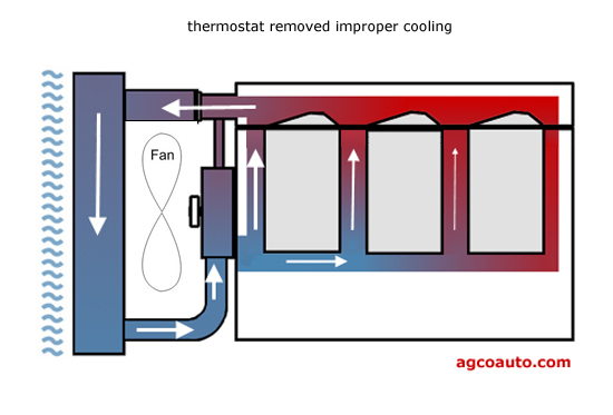

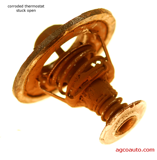

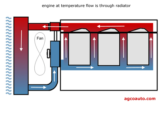

And this is also very educational and very interesting:
AGCO Automotive Repair Service - Baton Rouge, LA - Detailed Auto Topics - Engine Thermostats, Fuel Milage and Over Heating
Most folks realize an engine thermostat can cause a vehicle to overheat. Did you know thermostats are also one of the leading causes of poor fuel milage?
Engine thermostats perform three major functions
  1. Help an engine to reach operating temperature more quickly
  2. Help regulate engine temperature to prevent overheat
  3. Restrict flow to promote more even cooling
A cold engine waste fuel
Most modern engines operate close to 200 degrees Fahrenheit. Below this operating temperature is considered cold and the engine needs more fuel to run properly. On older carbureted engines, a choke was used to add more fuel. With fuel injected engines the pulse-width of the fuel injector is increased. Increasing pulse-width also drastically decreases fuel milage. This is why it is desirable to reach operating temperature as quickly as possible.
When the engine is cold the thermostat blocks flow to the radiator and opens the bypass circuit. In this mode the water pump circulates coolant only inside the engine. The coolant is prevented from flowing through the radiator where it would be cooled. Instead coolant flows through the bypass and back to the water pump. The effect is a quick increase in engine temperature.
How an engine thermostat works
The thermostat is basically a temperature controlled valve. The spring loaded valve is attached to a small cylinder filled with thermal wax. As the engine warms up, coolant transfers heat to the wax-filled cylinder. The heat causes the cylinder to expand and pushes down on the spring loaded valve.
When the thermostat opens flow to the bypass port is blocked and flow to the radiator is enabled. The water pump now pushes coolant through the engine and out to the radiator, where the heat is removed. Lower temperature coolant leaves the radiator and circulates back to the water pump completing the cycle.
If the temperature begins to fall below the limit set by the thermostat the flow will be restricted until it rises to the proper level. In a well maintained cooling system the thermostat will last for many years.
As coolant ages, the additives that prevent corrosion are depleted. This causes a huge amount of damage to the system and can cause thermostats to stick. If the thermostat sticks open, the engine runs too cold and waste fuel.
Engine overheating
When a thermostat sticks closed the engine will overheat. Overheating causes cylinder heads to expand greatly. This has the effect of crushing the cylinder head gasket and can crack the head[s]. Pistons also expand and gall the cylinder walls. Overheating, even for a short while can severely damage the engine.
A non-working thermostat should be replaced with the exact temperature replacement specified for the vehicle. Removing the thermostat will NOT increase cooling. An engine without a thermostat will flow too much coolant to the front cylinders and may deprive coolant to the rear cylinders.
Operating an engine without a thermostat can cause severe hot spots that may not show up on the temperature gauge. The sensor for the gauge measures temperature only in a small part of the engine. Rear cylinders could be severely overheating and not be revealed on the temperature gauge.
Removing the thermostat can also cause erosion damage to the radiator and heater core. The increased velocity of the coolant flow can easily wear through the thin metal tubes. This is far worse in a dirty system, full of abrasives, from lack of care.
Testing a thermostat
Thermostats can easily be tested with simple household items, if they are suspected of causing a problem. First inspect the thermostat at room temperature. It should be fully closed. Heat a container of water to a temperature 25 degrees less than listed for the vehicle. When the temperature is reached, submerge the thermostat, using a piece of wire. If the thermostat is good, it should not open.
Next bring the temperature of the water to the temperature that is listed for the thermostat (i.e., 195 degrees on most vehicles.) Again submerge the thermostat and it should open immediately and fully.
Any thermostat that fails either test should be replaced. It is also a good idea to replace the thermostat when other cooling system work is being done that requires it to be removed. This is most important on vehicles with higher milage and less important on low milage engines.
If your fuel milage is significantly decreased or if your cooling system has not been properly maintained, the engine thermostat should be checked. This inexpensive component can save literally thousands in repair.
Attached Thumbnails RIP - S Type R Engine may very well be dead.-engine_thermostat_flow_open_closed.jpg   RIP - S Type R Engine may very well be dead.-engine_thermostat_closed.jpg   RIP - S Type R Engine may very well be dead.-engine_thermostat_parts_with_bypass_valve.jpg   RIP - S Type R Engine may very well be dead.-engine_thermostat_open.jpg   RIP - S Type R Engine may very well be dead.-engine_thermostat_stuck_open.jpg
RIP - S Type R Engine may very well be dead.-engine_thermostat_car_overheating.jpg   RIP - S Type R Engine may very well be dead.-engine_thermostat_removed.jpg   RIP - S Type R Engine may very well be dead.-engine_thermostat_simple_test.jpg

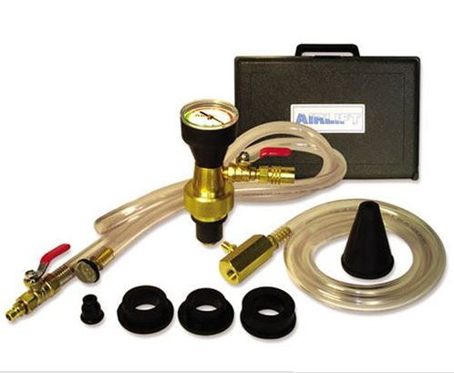

The easiest way to remove air pockets form a cooling system is by filling them with an air lift.
The air lift is a wonderful device which uses compressed air to suck the air out of the cooling system, rendering a vacuum. Once a vacuum has been achieved inside the cooling system, coolant can be installed leaving VIRTUALLY no air in the cooling system. I stress virtually, because no air lift will remove all the air, so make sure to still top off the fluid and bleed any air bubbles.
Once the cooling system is full of coolant, the next step is to verify the radiator cap is in good condition. A radiator cap controls the pressure inside the cooling system. As the coolant heats up and expands, pressure builds inside the cooling system. As discussed before, a cooling system requires some pressure in order to circulate the coolant. Too much pressure and parts of the cooling system begin to fail. A radiator cap opens and closes as heat and pressure rises and falls, maintaining the proper level of pressure inside the cooling system. Furthermore, a faulty radiator cap will also leak coolant, causing an air pocket. I recommend replacing the radiator cap on a vehicle every spring. They are generally inexpensive, and nearly every radiator cap in service will fail a pressure test.
Another inexpensive and highly critical cooling system component is the thermostat. A thermostat looks a little like this …..
A thermostat is basically a heat controlled valve. Until the engine coolant temperature reaches operating temperature, you want the coolant to stay in the engine, in order to warm up more quickly. The thermostat closes the radiator off from the rest of the cooling system. When the engine coolant temperature reaches the proper temperature, the thermostat opens and allows coolant to flow through the radiator, and thus be cooled. I highly recommend putting a thermostat in a pot of water and heating the water to boiling. Seeing a working thermostat open up just do to heat, is like watching magic.
Do not alter the thermostat if your vehicle is overheating. If you replaced the thermostat, and the vehicle sill overheats, there is another problem. Do not remove, drill a hole in, or force the thermostat to stay open.
A faulty thermostat can cause over heating, under heating, poor gas mileage, poor heat in the cabin, check engine lights, or emission failures. If the thermostat stays open, or opens too early, the vehicle won’t reach the proper operating temperature. If the thermostat opens too late, or not not at all, the vehicle will over heat. Again, a fairly inexpensive part. I recommend replacing the thermostat if the car has ever been overheated, and every few years just as a part of maintenance.

The last, and most costly cause of an overheating condition is a bad head gasket. When the head gasket fails, exhaust gas is forced into the cooling system, and the vehicle just over heats.

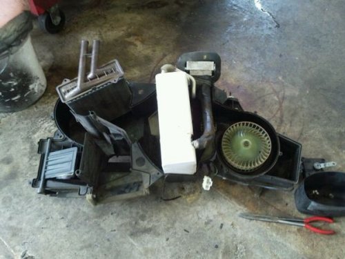

Next you’ll want to check your heater core. The heater core looks just like a small radiator, because it is. The heater core radiates heat, just like a radiator and then a fan blows that heated air through the ducts and into the cabin. Check out this picture of a heater box split in half, the heater fan is on the right, the heater core is on the left, and the A/C core is in the middle.
Just like a radiator, the heater core can become plugged or coated on the inside. If accessible, test the temperature of the hoses going into and out of the heater core. Normally, if the heater system is working, both hoses will be hot (as hot as the coolant in the engine) but a little less hot on one side (because heat has been transfered from the coolant, through the heater core to the air in the heater ducts). If one hose is hot and the other is COLD, the heater core is plugged, or coolant is not circulating through it due to an air bubble or another problem (VW/ AUDI are terrible for the water pump impeller coming off). If both hoses are hot, but no heat comes out of the heater, the heater core is most likely not transferring heat.

Attached Thumbnails RIP - S Type R Engine may very well be dead.-344__500x_scantool.jpg   RIP - S Type R Engine may very well be dead.-597__x_airlift.png   RIP - S Type R Engine may very well be dead.-598__x_thermostat.png   RIP - S Type R Engine may very well be dead.-205__500x_pontiac2.jpg
