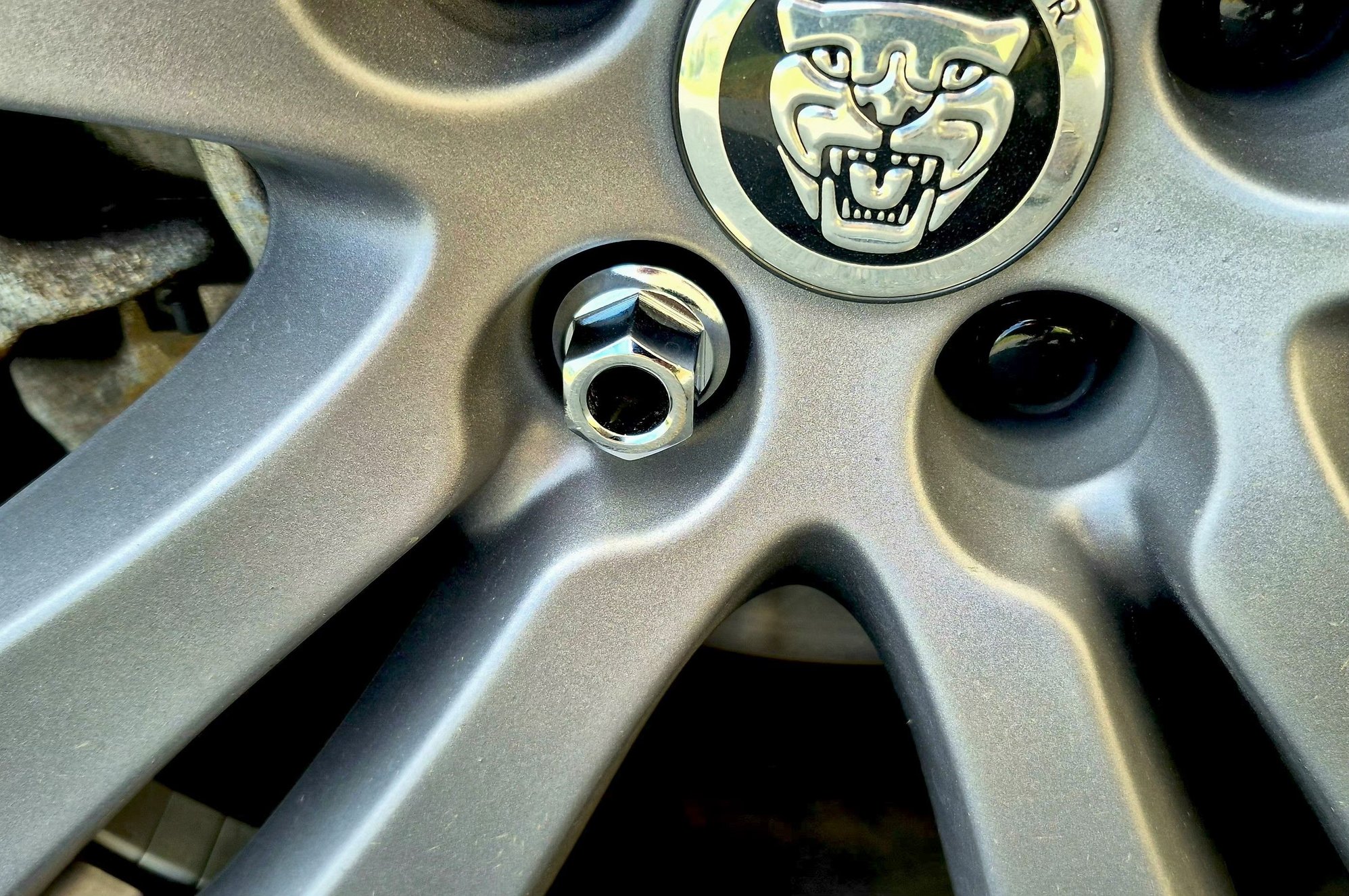

I was changing my wheels and the covers of two wheel nuts came off is it time for new wheel nuts or am I using the wrong socket

Generally it is better to use a 6-point wrench if possible rather than 12, but in your case the lugnuts are absolute crap. Get solid lugnuts, as you suspected, and you should be okay. I and many others purchased Gorilla solid lugnuts specific for our Jaguars and they work great. They sell them in chrome or black.

I think it was my DeWalt impact wrench it has crazy amount of torque and vibrations and possibly the 12 point wrench
Will not be using it to loosen and tighten anymore

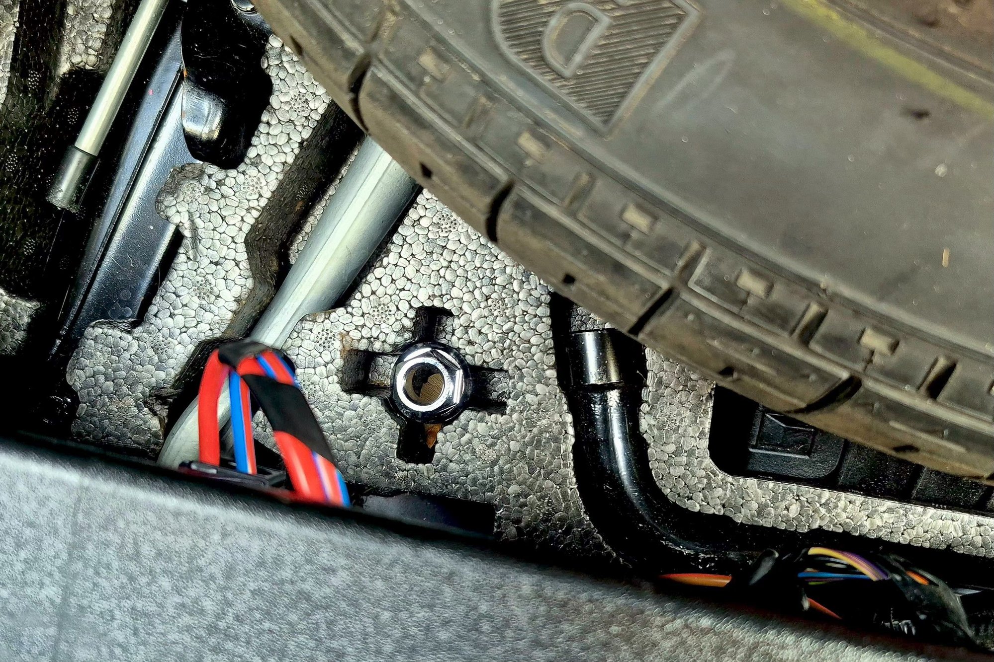

For those that use the common "Toyota" upgrade nuts, you'll have 13/16" as opposed to 3/4". Gorilla makes an adapter, part number 341316. I like this as opposed to replacing the lug wrench, as it is thin walled and fits nicely into the wheel without damaging it.
Bonus points (at least in my 2016) for a cutout that seems custom made to hold it in the trunk.

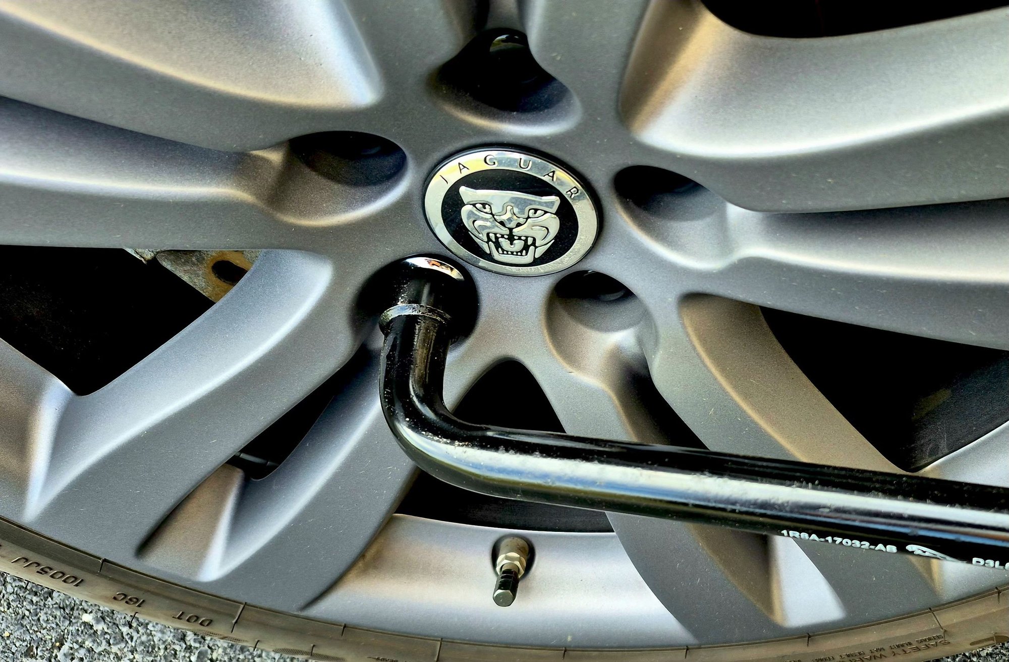

I replaced all my lugs with the 21mm aftermarket set. A $15 Harbor Freight collapsible 4-way lug wrench fits in the spare tire area, not snugly, but it hasn't been rattling around. The extra leverage of the 4-way T-shaped wrench makes it easy to change a tire on the roadside (which I've had to do twice since then).

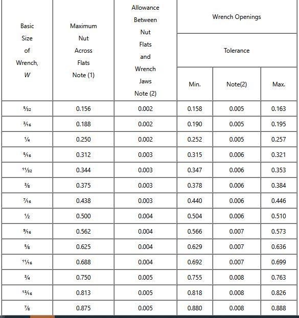

Originally Posted by JoshMcMadMac
19mm is the equivalent of 0.748", that thousandth of an inch is negligible.
For clearance purposes, wrench and socket openings are actually larger than the fasteners they are designed to turn, and vary due to manufacturing tolerances.
As the ASME B18.2.2 Wrench and Socket Openings for Hex and Square Nuts chart below shows, a 3/4" socket can have an actual opening of 0.755" to 0.763", or even larger if the socket is worn.
